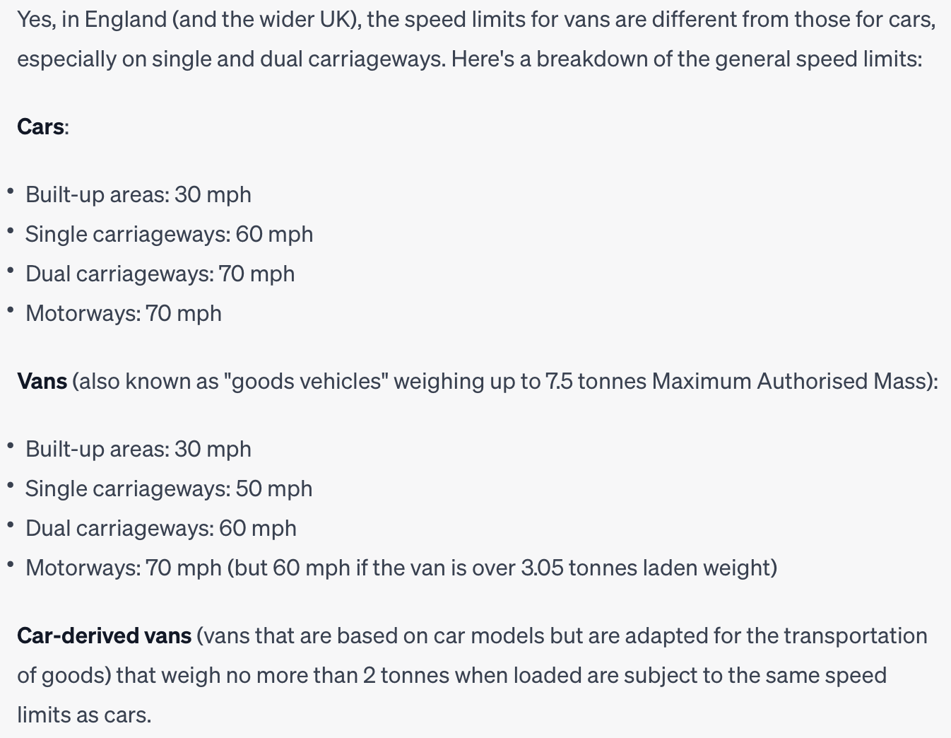

I include the info below for fellow dimwits (assuming they can read):
Your screenshot is incorrect!
Motorhomes over 3.05t UNLADEN weight are limited to 50mph on single carriageway, 60mph on dual carriageway and 70mph on a motorway.
