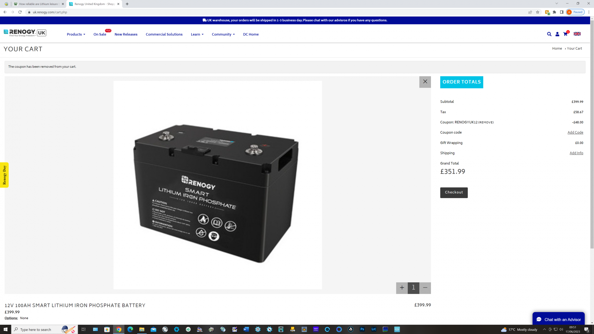

I've had three Renogy 100 amp Lithium batteries in my Campervan for over two years.With no issues at all. I've just added the fourth battery,as Renogy have a sale on at the minute.you can get 100amp Lithium battery for £351.99.If you add the discount code (RENOGYUK12) or two for £686.38.
