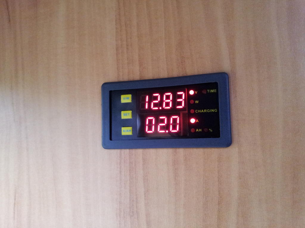

Also the Battery State of Charge meter is totally calibratable so when your battery is fully charged, you wait till it settles to the true voltage (test with and accurate meter) then set that voltage in the meter so you get the true voltage level, you can do that with the hours left in battery and watts amps ect

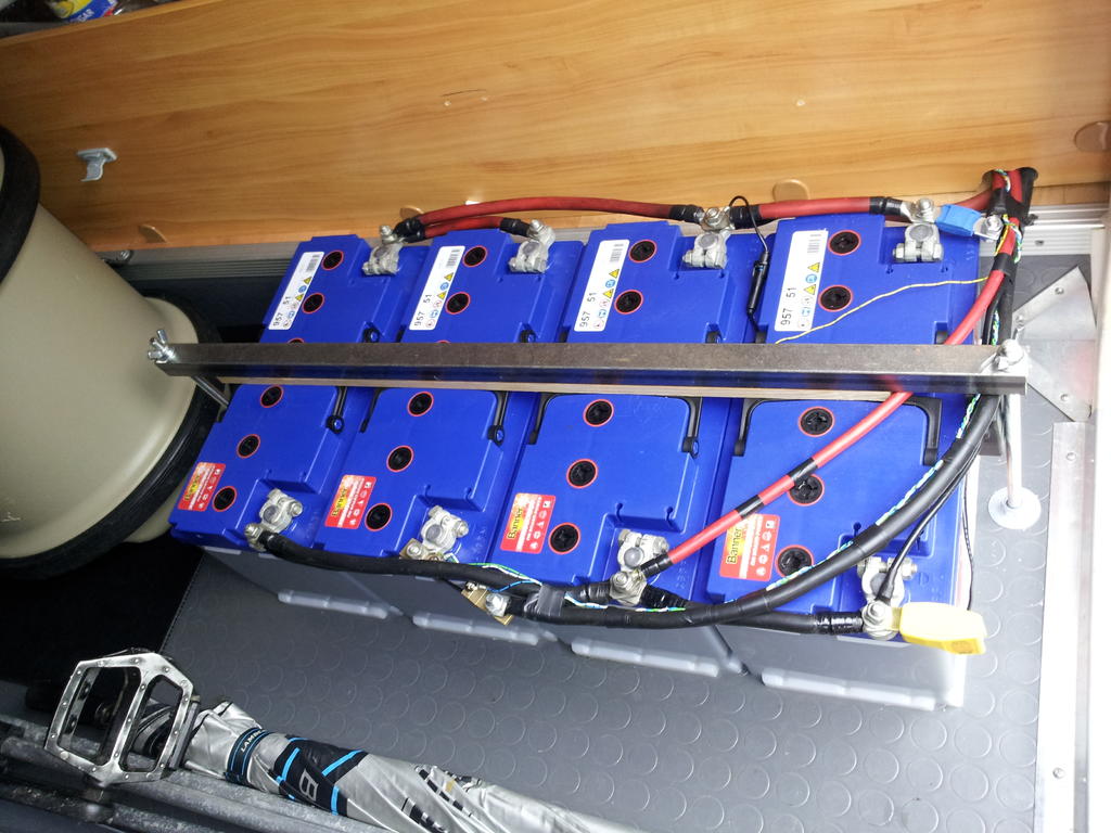

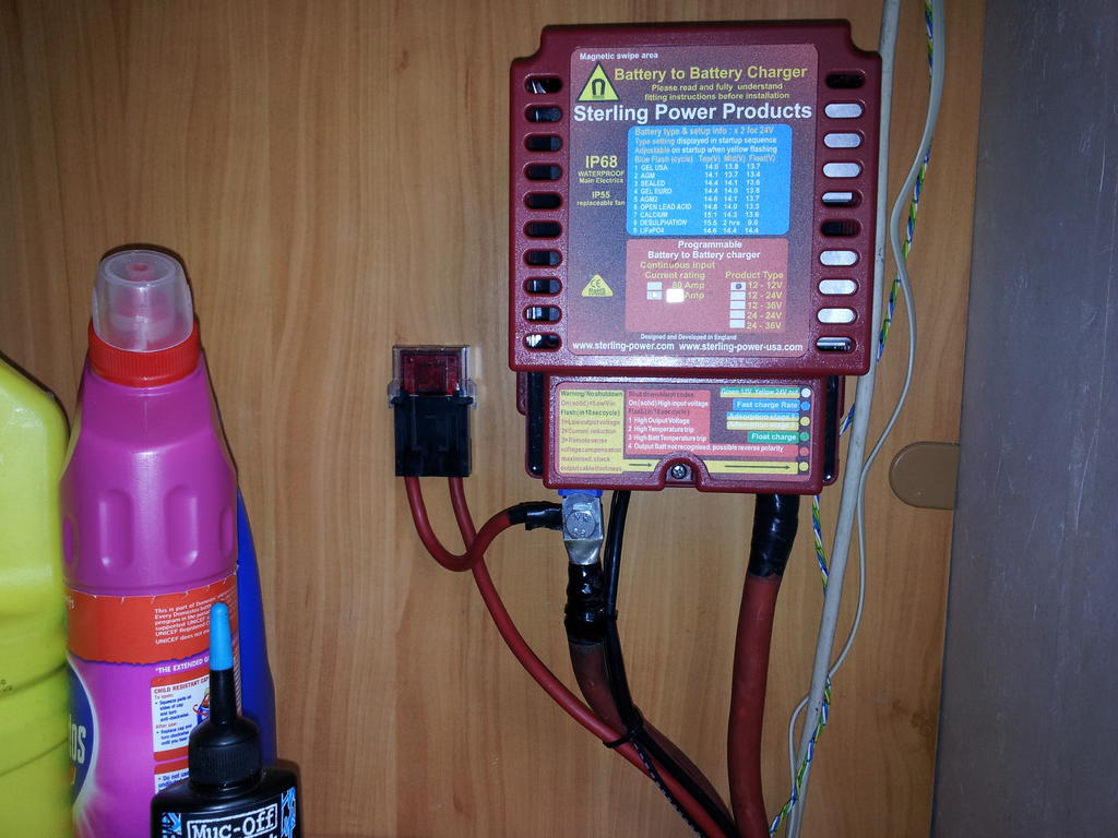

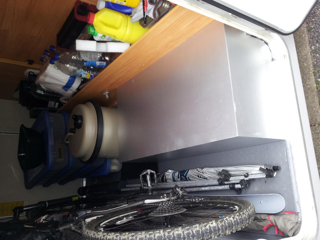

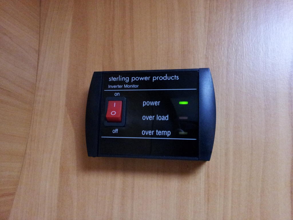

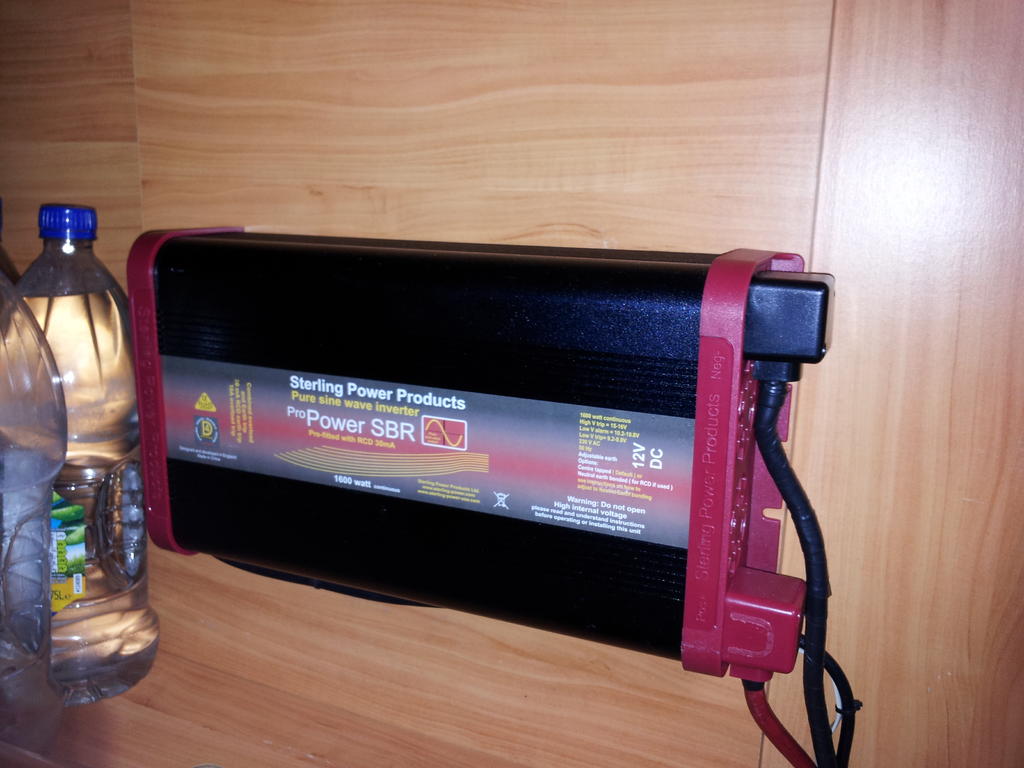

Heres a few photos of mine I fitted
20151107_130017.jpg20151107_130519.jpg20151107_130144.jpg20151107_130420.jpg20151107_130820.jpg20151107_130605.jpg
its not a variation of 4, its the same as
I mentioned a variation as you have to sets of connections in two different places, Maybe one for charging and one for draw that would result in a slight difference in charge/discharge performance. Nice neat install.

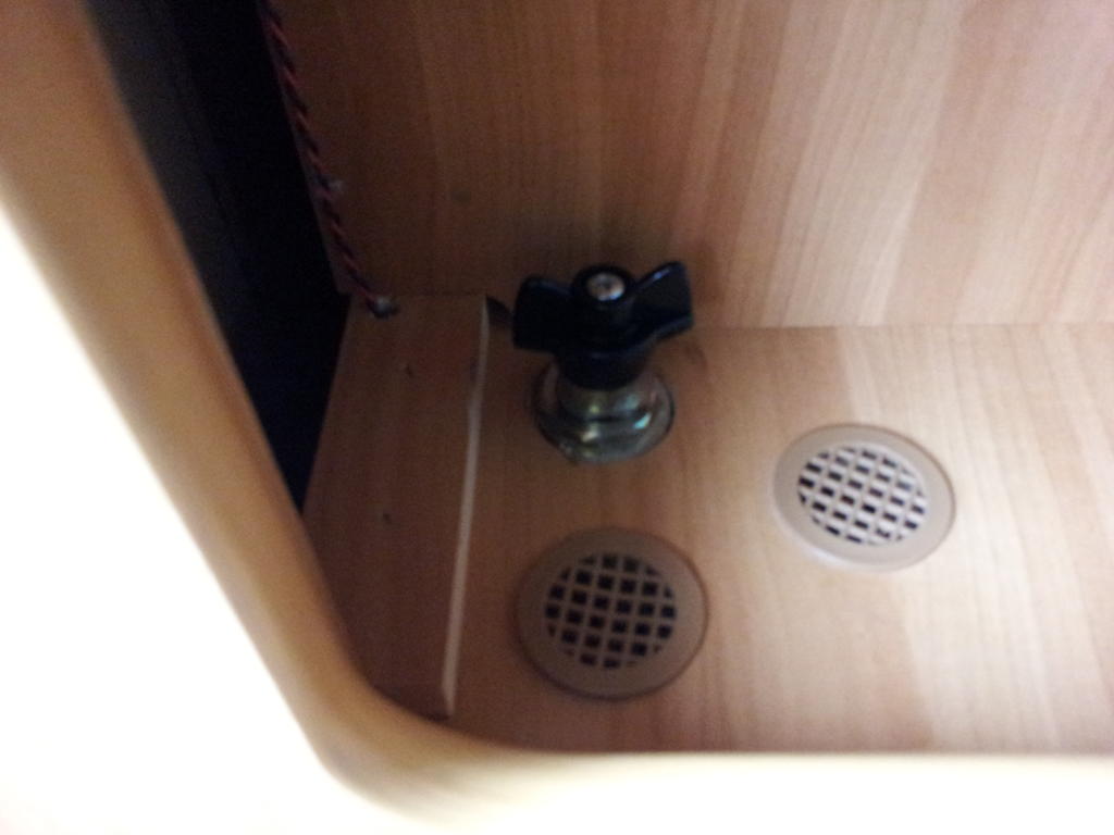

Good point there, I might change that, mind you I have never used it to date, the fused connection to the RHS goes to the front of the van and is connected to the van leisure battery, I did that as a backup if the van battery was ever getting low or there was a problem with it we would never get left in the dark. but never needed it yet, the switch in photo 3 is the isolator switch for that. The battery bank in the photo just feeds the inverter which supplies the microwave, TV and Sky box and a few separate sockets for laptop, phones ect.

I didn't need to alter anything like this, when I installed a Sterling B2B charger.
i have not got the alt and battery temperature sensors. Will it still work without them to make sure
its ok then i can order them up
As already pointed out, these are only a safety precaution. It will work fine without them, but if you want some, I'm sure that I have some. Just give me a pm, and I'll post them to you.
thanks very much i wil linstall it first. Where did you mount your b to b charger in your hymer as it is the same
model B544 as mine
