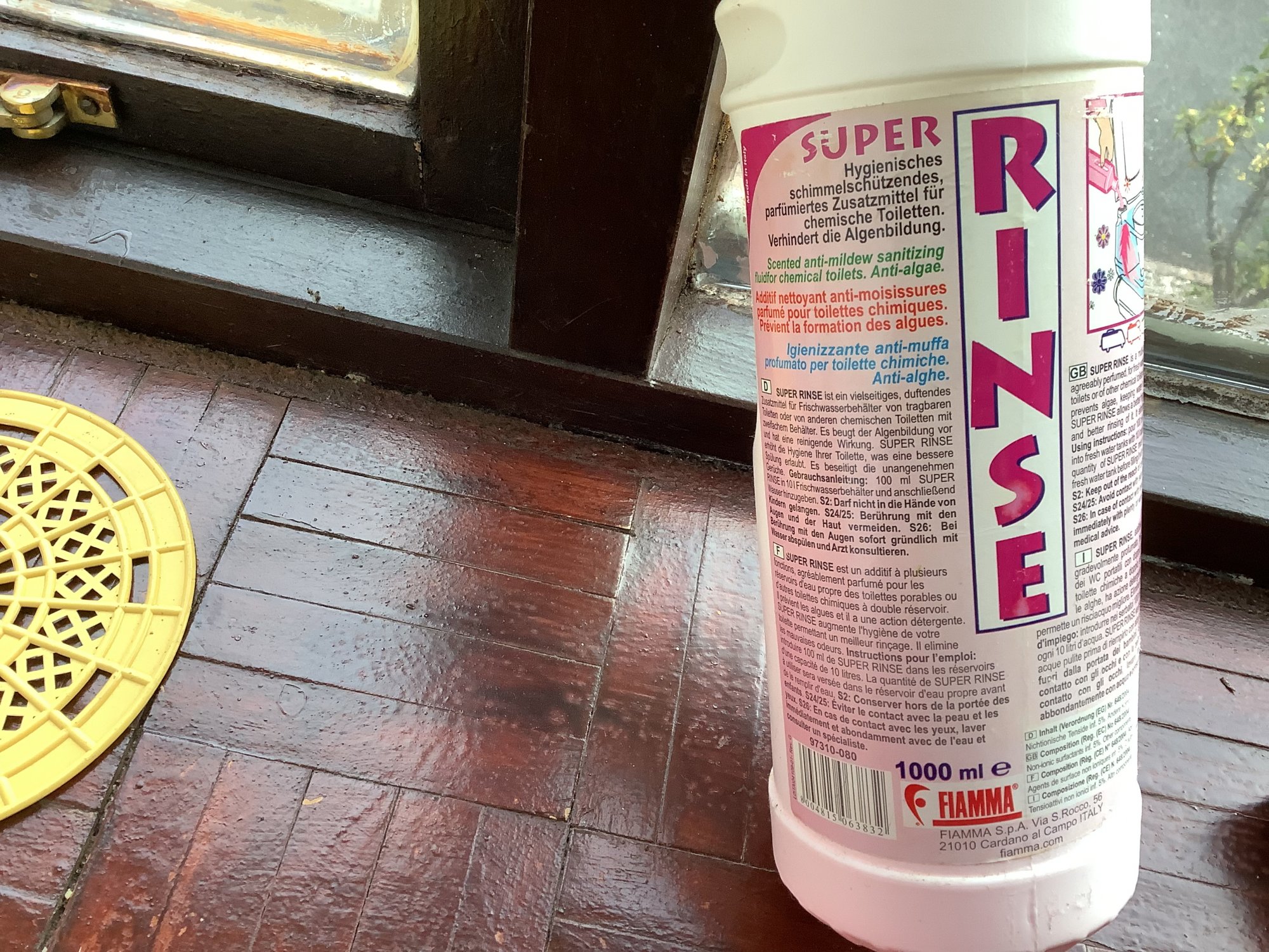

Hi, bit late but my b.half recommends putting this product down your sinks it is a Fiamma product ( so prob costs) but as it filters down into the tank it keeps whole system smelling good..see photo it is called Rinse. It is supposed to be for those vans which put it in their toilet flush.
