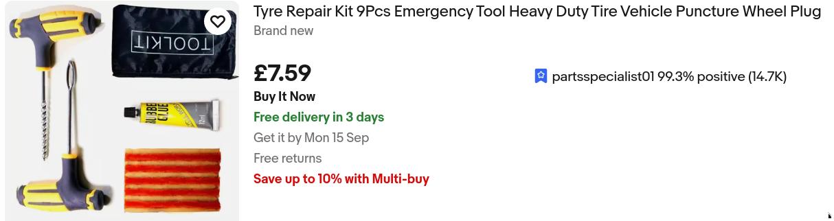

What you should have done is pull the nail and put a plug in, there is a small kit for this and easy sorted and will last the life of the tyre.
