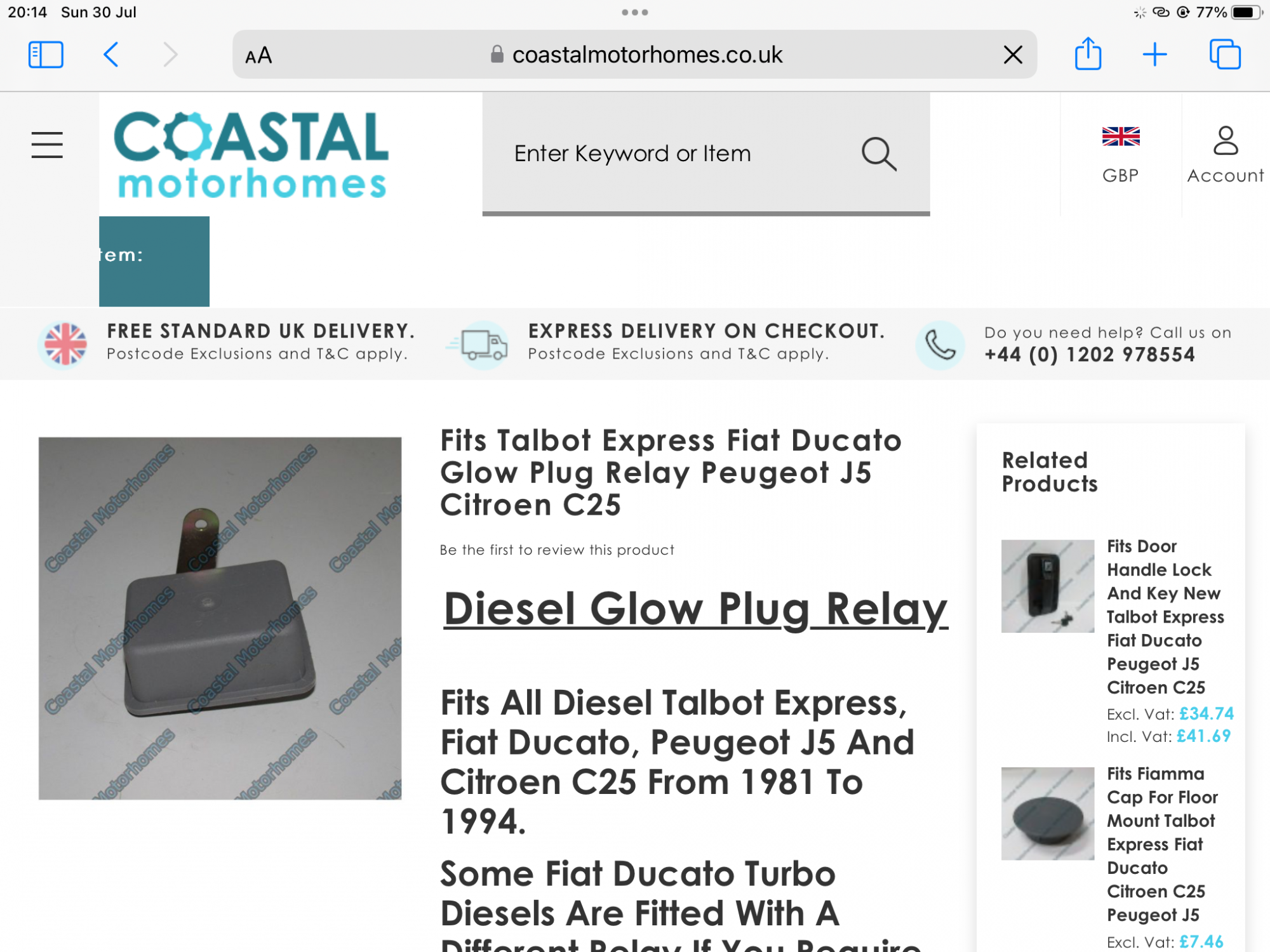

It may look like this
Just a point don’t think it looks like the relays in your glove box , on my 94 Hymer it was probably about 4 inches long with quite heavy cables and if I remember correctly it was blue.
Thanks for everyone's replies .and sorry for the long delay .I did find the glow plug relay ..and spoke to coastal motorhomes .
Unfortunately they have stopped making them and can't be bought can only get second hand or can get repaired but he didn't know where repairs them .he did say seen as mine was direct flame it should still start ok without
