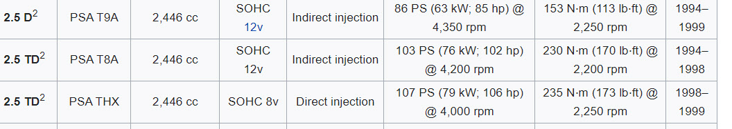

Just read your posts on a difficult year and noticed that yours is a 1999 2.5 Peugeot so it doesn't have a common rail engine so ignore the above, I thought it was a later model and the common rail engine was introduced in 2002
Yours could be any of the following

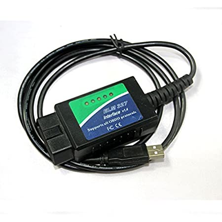

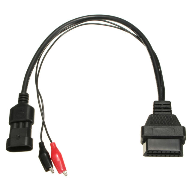

Unfortunately, it will not have the OBD11 port either so a diagnostics code reader will not help, Fiat Ducato's of that year have a 3pin plug at the side of the air filter near the ECU
it can be read using one of these
and this
to link to a laptop,
Peugeot's are different though but your garage should still be able to help, I use the items shown for my 2002JTD
