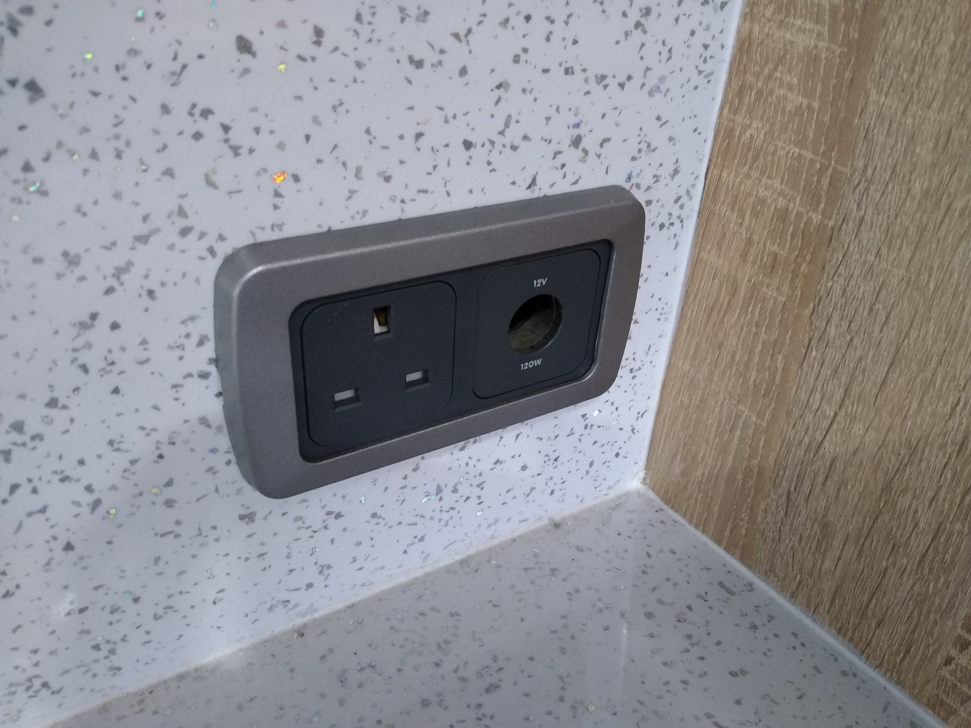

What Brand of Motorhome do you have? You might find there is a Mate 'n' Lock Connector somewhere lower on that white flex. You could make (or have made) a spur to come off that connector which would be the neatest way to do it.Ok my next step is to create a convenient mains power source for the new charger.
There's a mains plug v close to the wardrobe and the leisure battery lives in a decent space underneath the wardrobe false floor. I'm thinking of extending the mains power from the existing plug through into the wardrobe.
But I'm not sure how, or it's possible/wise to create a spur from the back of the plug. If I could do that, it would be easy to run cable down to near the leisure battery and install another mains plug from where the new charger would run.
I'd welcome any advice on how to convert the existing mains plug socket into one that will take the mains power another meter or so into the wardrobe. I presume that's doable.

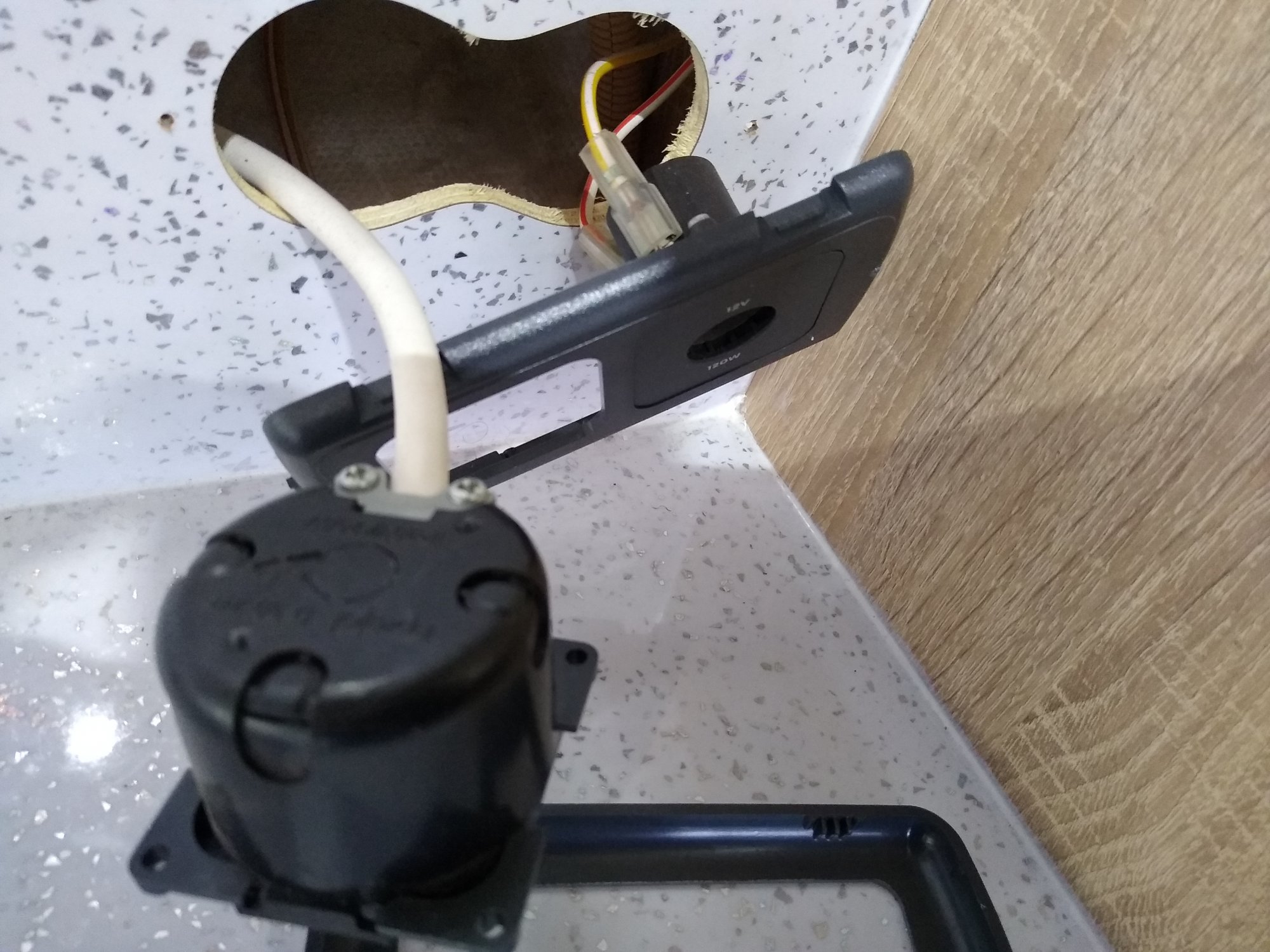

View attachment 118207View attachment 118206

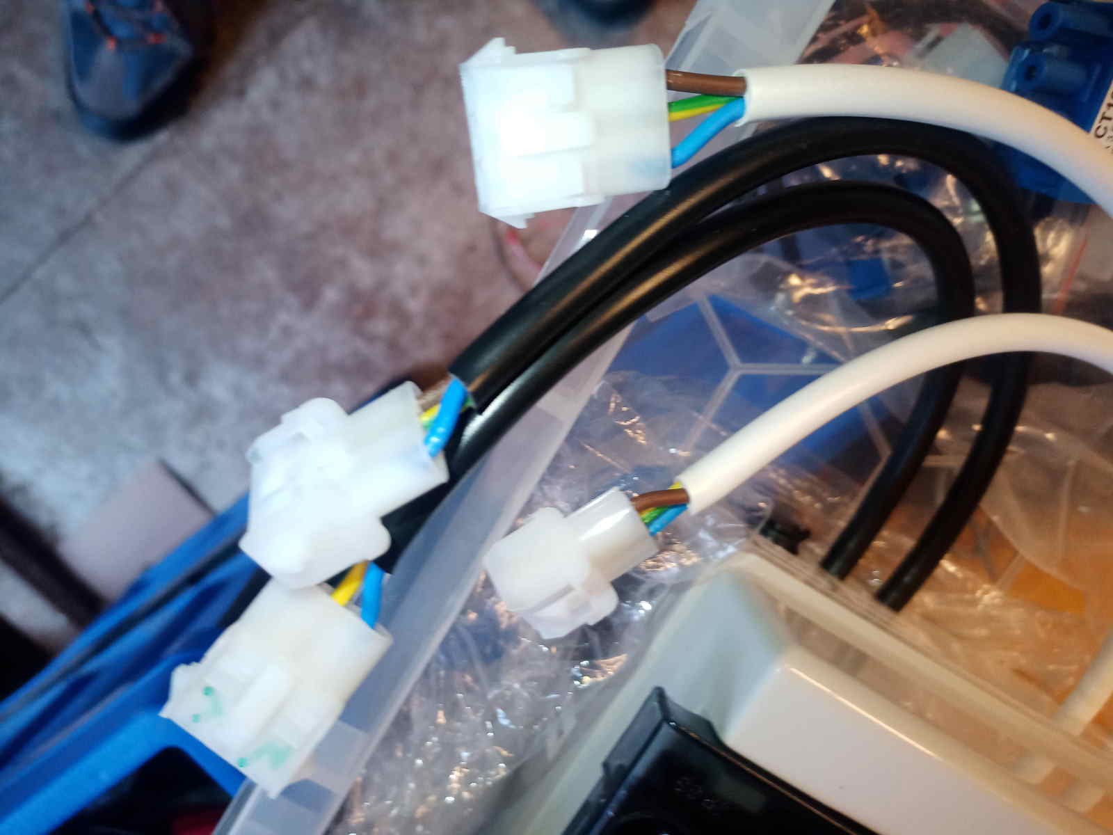

Interesting. There's not much slack on the white cable and then it's inaccessible for quite a distance, so I don't think I'll find a mate n' lock. The cabling on the plug does though does look quite tight, so squeezing in an additional cable might be hard. Instead could I break into the white cable and use some kind of mate n' lock device to supply the existing plug with a spur to my new extension? Maybe that's partly what you were suggesting? If so, I can't quite figure out the necessary bits from your photo.What Brand of Motorhome do you have? You might find there is a Mate 'n' Lock Connector somewhere lower on that white flex. You could make (or have made) a spur to come off that connector which would be the neatest way to do it.
This photo shows the connectors you would look for .....
There is nothing wrong with adding a second cable to the socket itself but be aware that those CBE sockets can be fiddly to work with.
I was wondering the make as I don't know if everyone who fits Sargents use the Mate 'n' Lock system as well? Autotrail do and it makes it quite simple to remove a 240V socket to work on.Interesting. There's not much slack on the white cable and then it's inaccessible for quite a distance, so I don't think I'll find a mate n' lock. The cabling on the plug does though does look quite tight, so squeezing in an additional cable might be hard. Instead could I break into the white cable and use some kind of mate n' lock device to supply the existing plug with a spur to my new extension? Maybe that's partly what you were suggesting? If so, I can't quite figure out the necessary bits from your photo.
