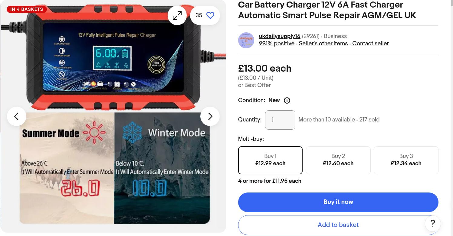

The fact that you had 2 chargers and neither worked would cast suspicion on the connections. The 'wiggle method' is a must. AND AVOID PAINT!Hmm ....thanks meri.....thats a possibility...neg, was attached to body (metal)....was good connection
pos.had to go on a very small nut.......could be the problem
Many modern chargers do a diagnostic check before commencing the charge, IF the battery is absolutely dead flat these often won't work and an old fashioned dumb charger is what you'll need. If you've got any local friends or neighbours you could ask you could borrow their charger and try a couple of alternatives, Bill down the road with his charger from 1970 is probably what you need
