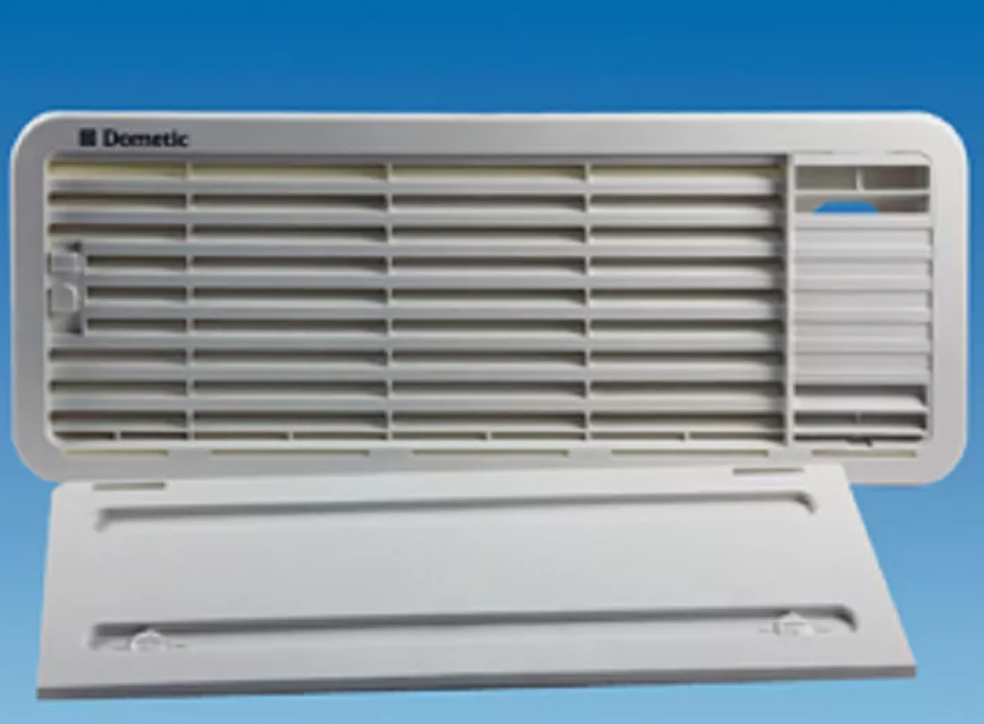

I've fitted the proper covers on this van. Over the years the crud and muck and rust on the old flue on the fridge in the old van caused havoc with the fridge every year. I reckon a lot of it accumulated where it was parked over winter on the drive and just general exposure. The two LS200 covers I have now cover the flue and the vents with a tiny ventilation gap at the bottom. Apparently they help the fridge efficiency in temperatures below 10c but for me the important thing is keeping the crap out. You would need to remove the top one though if using gas.
Some of the vans have had them I just never fitted them, none have been your type at the top though, they were always shorter so the fridge could work on gas.

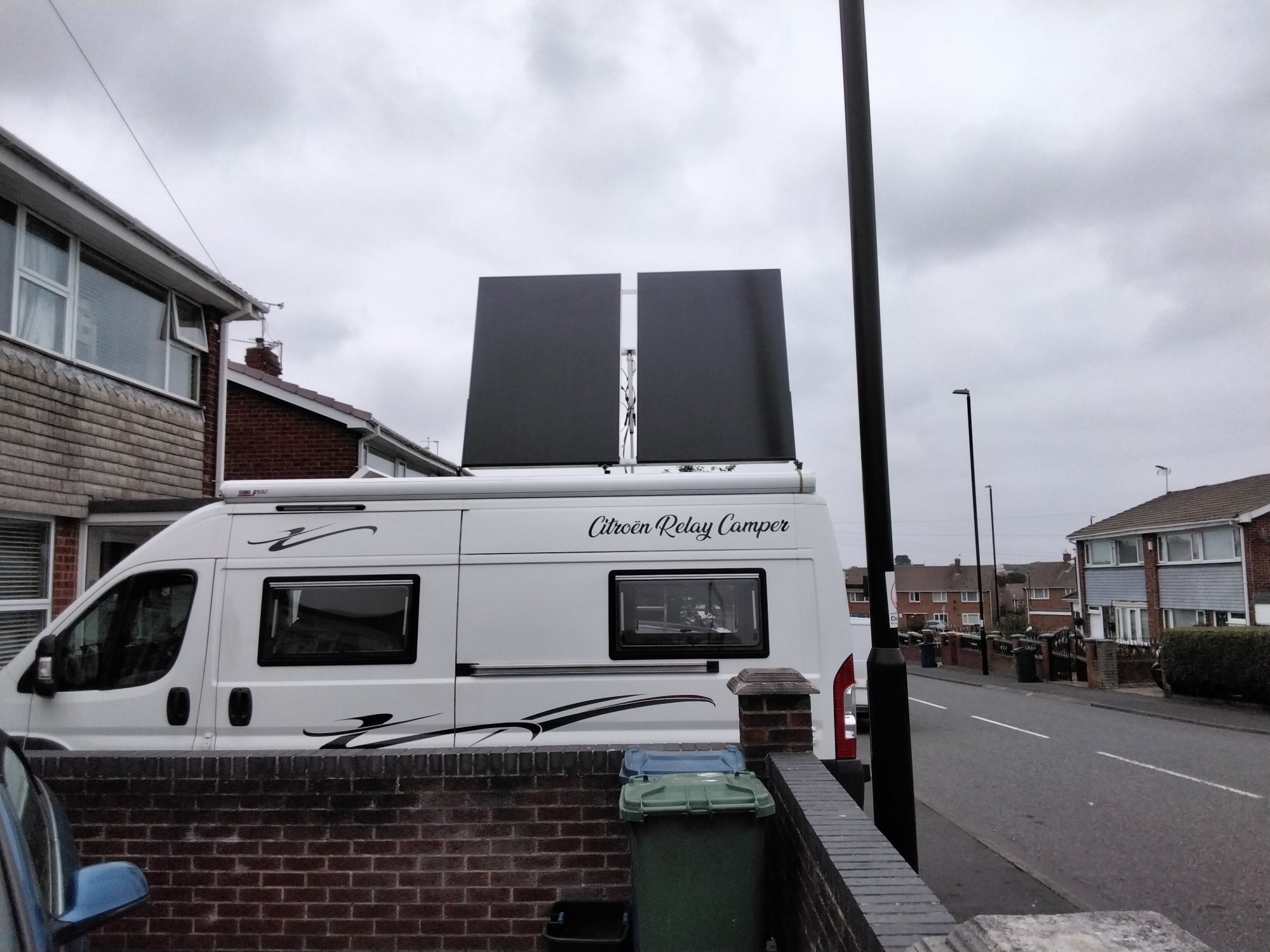

I have 600watts of solar + i can tilt them up to 90 degrees and it make a huge difference in the winter .
