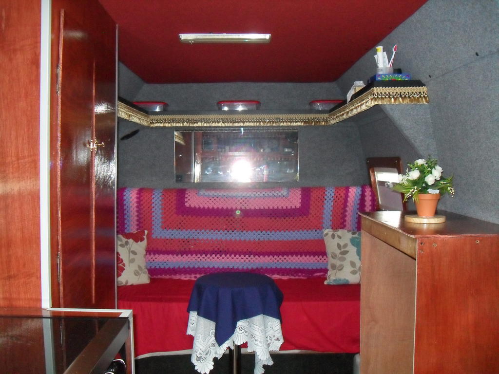

I still have a few finishing details to do, but I have been busy using the van, and do little bits when it's not raining and cold!
It is cosy, and toasty, due to putting insulated bulkheads in, so neither the cab, nor the back doors, let any draughts rob the heat. But in summer it keeps the van a lot cooler. It's win win. The one thing I am constantly planning is the removal of the sliding door, and having a hinged caravan type door. Lots of thinking, planning, brain hurt to go through to make that happen.:scared:

not that hard to do really,start by sikaflexing the SLD ,then cut out the rectangle. i did one on a 814,and bought a door and frame from magnums
