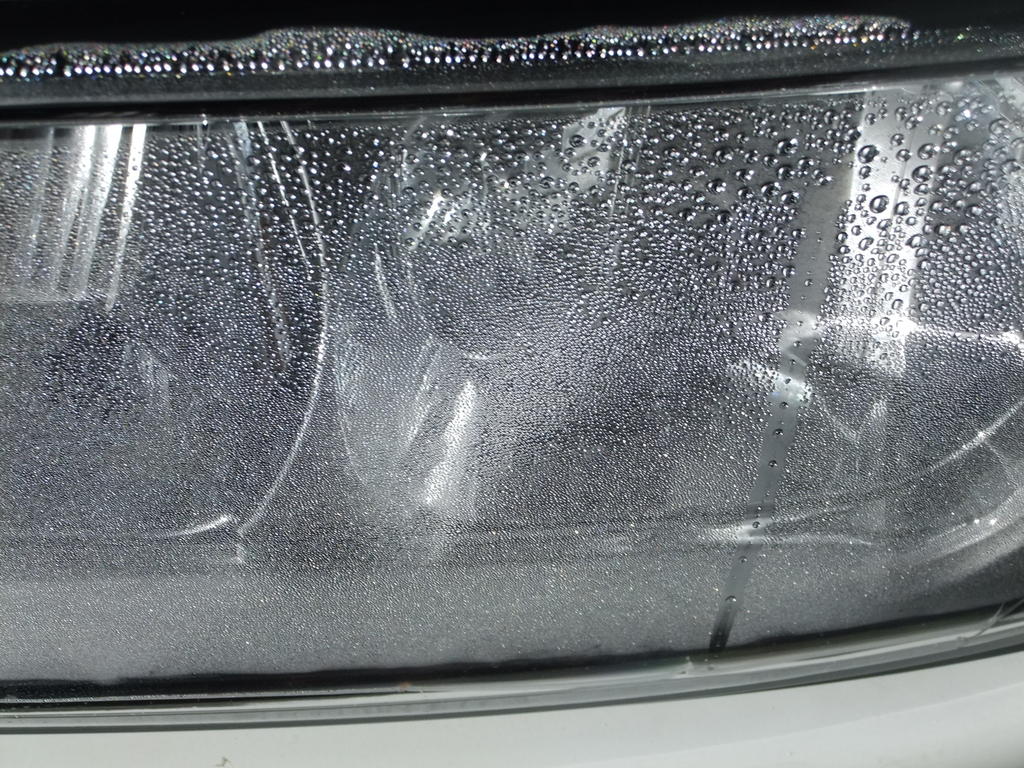

DSCF5945.jpgDSCF5945.jpg Just to let you know i have had a problem with 2 head lights bought of ebay. We have a Peugeot boxer and we needed 2 new head lights looked on ebay and there quite a few firms on ther selling them from about £45 to £65. found a company with good feed back, ordered them good service arrived in a few days. They looked great, fitted them and they looked great, so binned the old ones BIG MISTAKE. Went to the van in a couple of days and could not believe what i saw they were nearly half full of water. The company's answer was we have sold hundreds of them, a replacement was sent, another night of rain and yes half full of water. In the end i got 2 lights from a breaks and is now all ok. So if you need things like lights i would suggest you get genuine ones not ones from some way of country.
Like most light problems this could have been sorted with a small tap:lol-049: geritt small tap ok I'll get mi coat
Yes i did, I was just trying to make a point but beginning to wish i had not bothered. I said they were good because it took a long time to find s/h head lights, so i could not send them back straight away, and they had sent me 2 sets all ready. i think they have taken it up with there suppliers. They refunded the total price plus all postage, i don't think they could have done much more. So as the post was intended i think on this type of thing you would be better to get a genuine part. i do know a lot of copied thing are very good and save you money

Boxer / Ducato /Relay / Jumper Lights
There's something odd going on here, and I can't get my head around it.
When we were shopping for a used Sevel Sud type van a couple of years ago, one of the dealers had a Citroen Relay headlight dismantled on his desk to dry out. He said he often found they were half full of water. It only happened with Relays, even though Boxers and Ducatos are made in the same factory and appear to have the same headlights.
We eventually got a Ducato. After a couple of years with no problems I reversed into a tree and cracked a rear light cluster. The replacement cluster (from Ebay, but it appeared to be a Fiat part) looked just like the old one but within a month it had an inch of water in it.
The best solution I've found is to drill a small hole near the bottom for the water to drain out. Try to use the van regularly so the lamps get hot and dry themselves. Not perfect but OK. I still can't see how the water gets in.
Another likely spot for water ingress (assuming that there are no cracks in the lens or the body) is the join between the glass lens and the metal body of the headlamp unit.
Of course, this "shouldn't" happen on a brand new headlamp, but depending on the price difference, it may still prove to be much cheaper to run some sealant around this join rather than pay a much higher price for one from the manufacturer, assuming that one is available.
