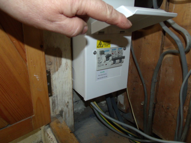

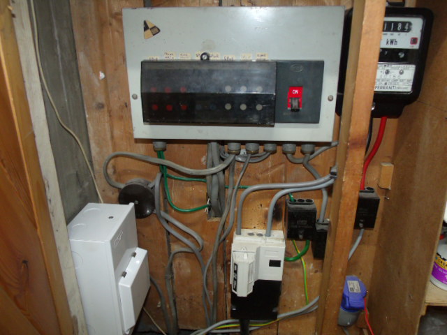

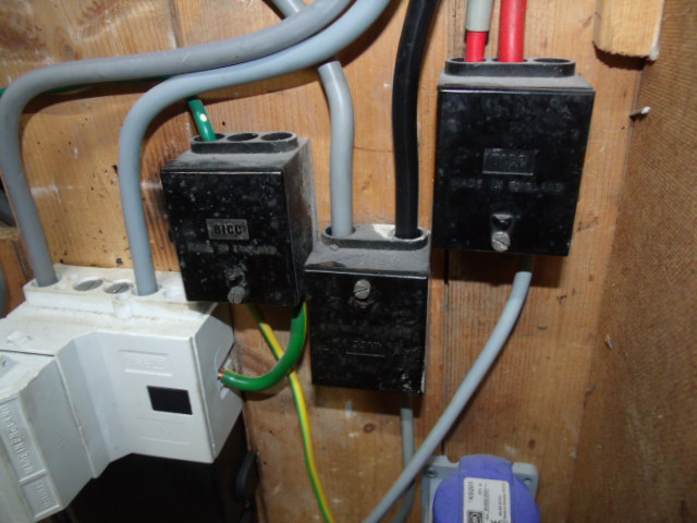

Yes i had to connect the new trip to 3 black boxes which are on the tails coming out of the meter, these tails have 3 spaces in them for a gen and stuff like a new trip box as mine, double fuse/trip, one for shower 63amp and one 32a for garage, garage was orig fitted to the old style fuse box to which i will be changing down the line.View attachment 92287View attachment 92288View attachment 92289

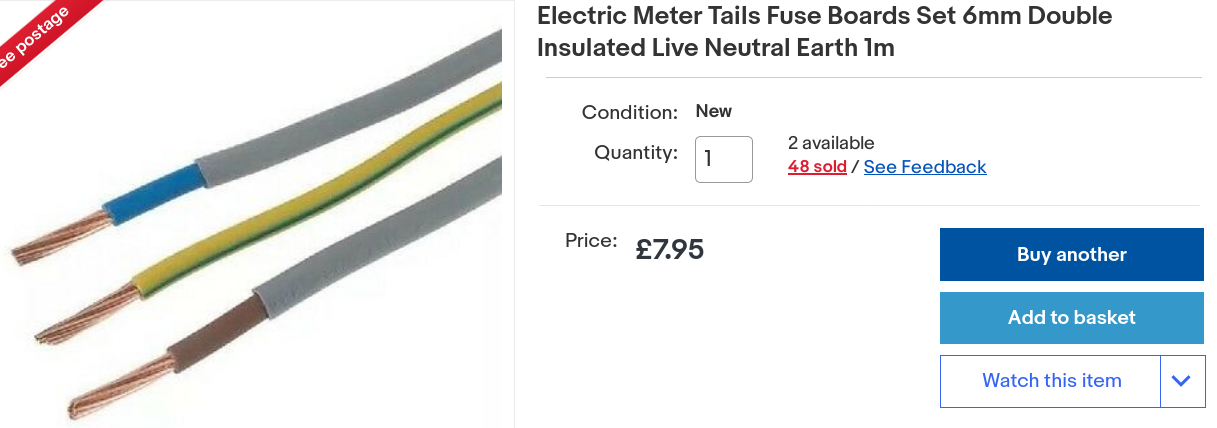

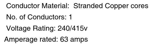

6mm rated to 63amps, my shower uses 44ah leaving me 19ah for garage if used together, but i will never be using both together and am covered for the 60% rule.OK, so you were connecting a new consumer unit, I understand. I hope you've got a fireproof grommet in the bottom
Your tails look thin too...
6mm rated to 63amps, my shower uses 44ah leaving me 19ah for garage if used together, but i will never be using both together and am covered for the 60% rule.View attachment 92295View attachment 92296
Its a sub box and not the main one of which is feed by big fat cables for all the other house stuff, look at the picture again.Jesus. That has to be 25mm2 here, irrespective of what it's feeding. The reason being, the main distributor fuse is often 100A and the cables need to be able to handle that in the event of a fault.
