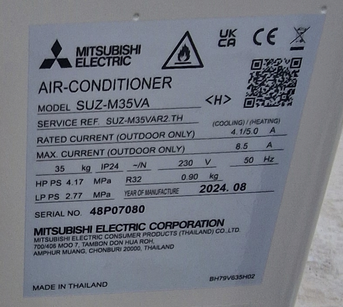

The Mitsibushi electric split inverter systems we install (that's internal inverter to drive the DC Variable speed compressor not external inverter)
Consume a relatively small amount of power...
A 3.5kw (cooling power NOT input power)
Will usually only pull 3.5/5 amps (and often less than that when the room has cooled down)
so around the same as a 12v compressor fridge....
However it will be running for longer as it's dealing with a larger area than a fridge....
BUT on a sunny day in the heat a decent solar/battery set up should cope.
If I am understanding you, this unit pulls 3.5 to 5 amps running on 230v ac
To run it on an inverter would pull >70 amp from the 12v battery.
My 240v fridge only pulls the same 2.5 to 5 amps.... From my inverter
Granted the ac unit would run for longer... But on a sunny day
A decent solar panel would keep up with that through the heat of the day?

How much current and at what voltage does the A/C unit pull?.
OP is asking about A/C to cool 30,000 litres and not a fridge to cool 100 litres.
A cigarette lighter uses a lot less petrol than a Range Rover
240v Between 4 amps and 5.... On cooling
Though once room is down to temp around 3 amps or so
3 amps at 230v will draw 60+ amps from a 12v battery using an inverter.
A typical leisure battery (120ah) will only give about 60 ah before it is flat.
So running the A/C from a 12v battery is not practical.
So that's 1kw-1.25 KW, a proper 100Ah lithium would be flat in an hour or so.
Battery power is 1/20 of the voltage of the mains so you'll need to draw 20 times the current to achieve the same wattage.
