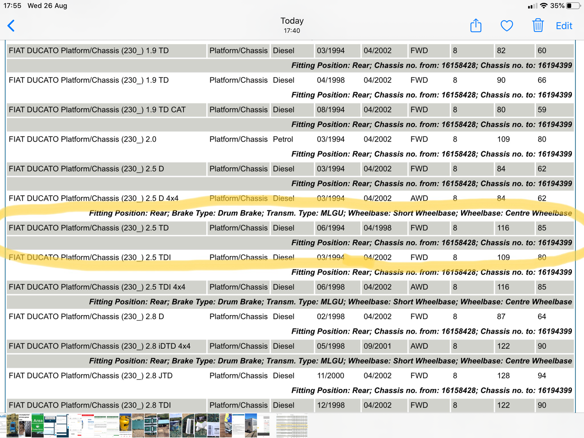

Hand Brake cable 1998 Peugeot Boxer 2.5 diesel !
Ours is a medium wheel base not a short wheel base and is a straight 2.5 D not a TD, does that make a difference?? :unsure:
Engine size shouldn’t make a difference but wheel base will.
It looks like you need to speak to coastal motorhomes as the have a some in stock, or try emailing Autosleeper

Speedy have been back in touch and there are two options.
They can alter the length of the (too long) inner cable and make a new nipple for it for a cost of £35, or they can make a whole new cable for £130, both plus VAT. Looks like altering an existing cable is the way to go - the garage apparently have 2 suitable cables already in their possession, but they are 200mm too long. Just have to retrieve the cables from the garage.... I'm sending Neil out the door to do this as I type... 😂:devilish::cool:
The garage have also muttered that they might be able to alter the cable(s) themselves if necessary (without me asking, shock horror!), but I think they are reluctant to do this as not only are they always up to their eyeballs in work (they haven't said that as a reason, but it's an incredibly busy garage all year round) but a lot will depend on the staff and who is actually capable of doing what and how busy they are with other stuff.
PS. Coastal Motorhomes have been good too, they got back straight away with a link to what they thought was the right cable on their website, but it isn't, so it will have to be the Speedy Cables route.
