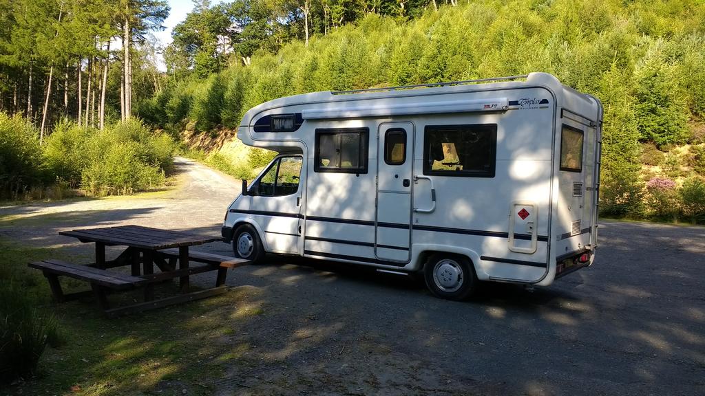

Nothing wrong with an older vehicle, we can afford to not pay to keep resale value as high as possible by buying into safety nets.
The annual depreciation of a MH that was only a few grand is not much, cosmetic maintenance = bugger all for us.
A scratch on the outside is character building not asset depleting.
