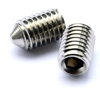

Maybe not something you can do yourself Barry, but perhaps you will know someone who can do the following.
With pin in place, drill 2.5 mm dia hole into long middle section of hinge part attached to door, allowing drill to part penetrate the actual pin, remove pin and tap M3 thread into the hinge, then insert 3mm hex grub screw into hinge and the part drilled pin itself, it won’t fall out after this.
Edit, pin can remain in place and have the hole tapped using a 3mm plug tap.
M3 grub screw.

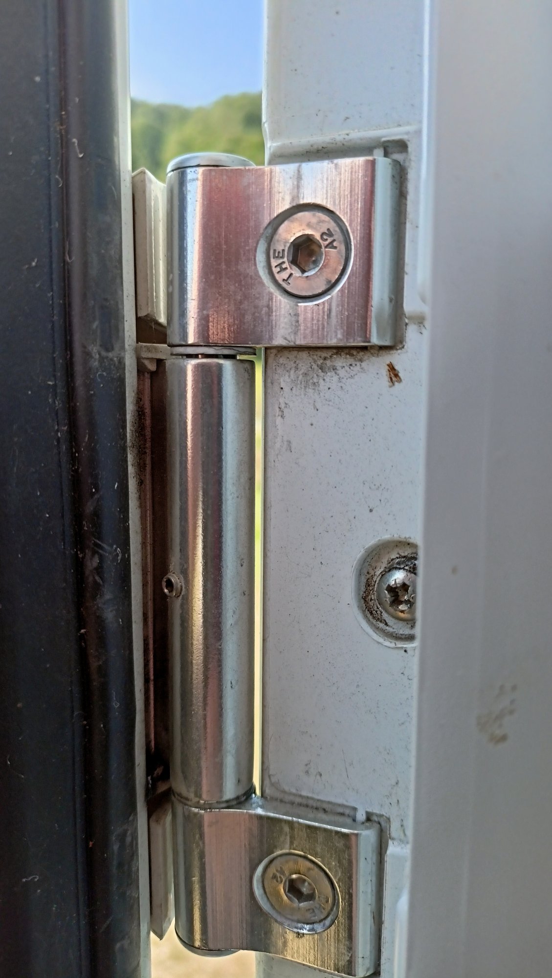

An update. After rummaging through various places you wont believe this but I found the right size allen key. The Grub screw is fine and goes in and out ok. It maybe looked slightly further out than the other two. I gave the other two a bit of a tighten for good measure but they didnt move. So I took the top one (the dodgy one) to bits again which was a right PIA as the bottom plug did not want to come out and I then put the washers back in which was even harder as the only way the whole thing lines up is when the door is shut and then its so high up (you can only do it from the outside). So I had to balance on the step and thankfully having lost a bit of weight my gut didnt get in the way and bounce me off with the door shut. :D Got them in though!
I could see no grove or indent in the hinge post when removed.
Anyway I got it all back together and tightened the grub screw.

My super engineering work so far. (Well the hinge as it now is)

I'm a little curious to know why it sticks out more than the ones on the other hinges Barry? That would sort of suggest that there should be some sort of recess for the screw to lock into - but if there ain't one on the shaft then it can't be.
Yeah, just squirt a bit of Loctite on the thread and screw it home again. Glueing the plug shouldn't do any harm either as long as you don't glue the hinge to the shaft at the same time!
I assumed the grub screw was sticking out a bit more than the others as it had vibrated loose a bit. It would be impossible I would think to line up a recess as all you can do is batter in the rod and lining it up would require some kind of Witchcraft I am sure. Anyway if I glue the bastud bottom plug its never going to come out I would hope.

I should have photographed all the bits really. I had to take the top cap / bung off as well to bang the pin back out to take it to bits this morning and I noticed the top cap had a recess hole in it and the bottom cap did not. I can see no way of positioning the pin in such a way that the recess hole if there was one would line up.
Personally I wouldn't put anything on the grub screw. One day you may want to get it out and little grub screws can be a pain. More than likely never touched since it left the factory.
I thought the idea of the thread lock blue stuff Rob recommended was that it just stops them vibrating out but they can still be removed with hand tools? To be fair it is kind of hard to get the allen key in and its tiny so you cant get much of a turn on it.
Agree with that, it’s very possible that the screw hadn’t been properly tightened from the beginning. Just make sure it’s tight enough now and check all is well every now and again. If it does come loose again maybe think about thread lock then but I’d be surprised if it was needed.
Probably right. Although the Blue Loctite is designed to release with a bit of effort, it would be quite easy to ream a small grub screw with an Allen Key.
