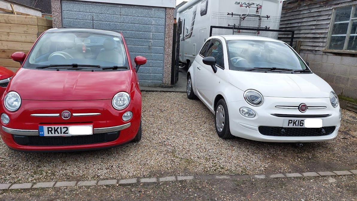

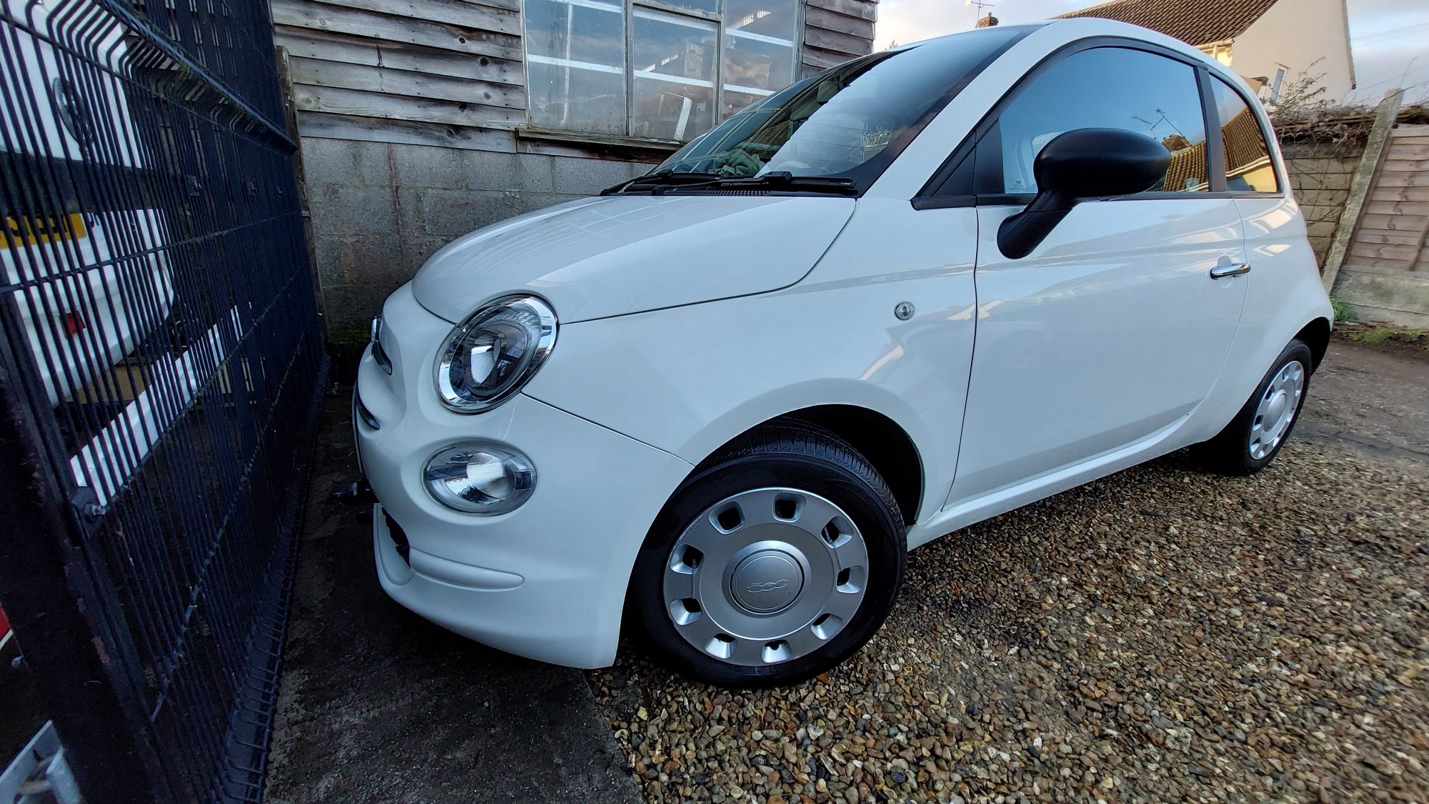

Whether right or wrong I Bought this one, complete with A Frame 😃
Looks good (y)

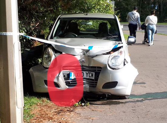

I realise your comment was tongue in cheek but, it does happen. On 17/10/21 in Weston Super Mare, a Low mileage Suzuki Alto had a total failure of the a-frame mountings. The installation was illegal in that it had neither an emergency breakaway system installed or a secondary coupling (not that the latter would have helped).
Pedestrians ran for their lives but fortunately, no one was injured.

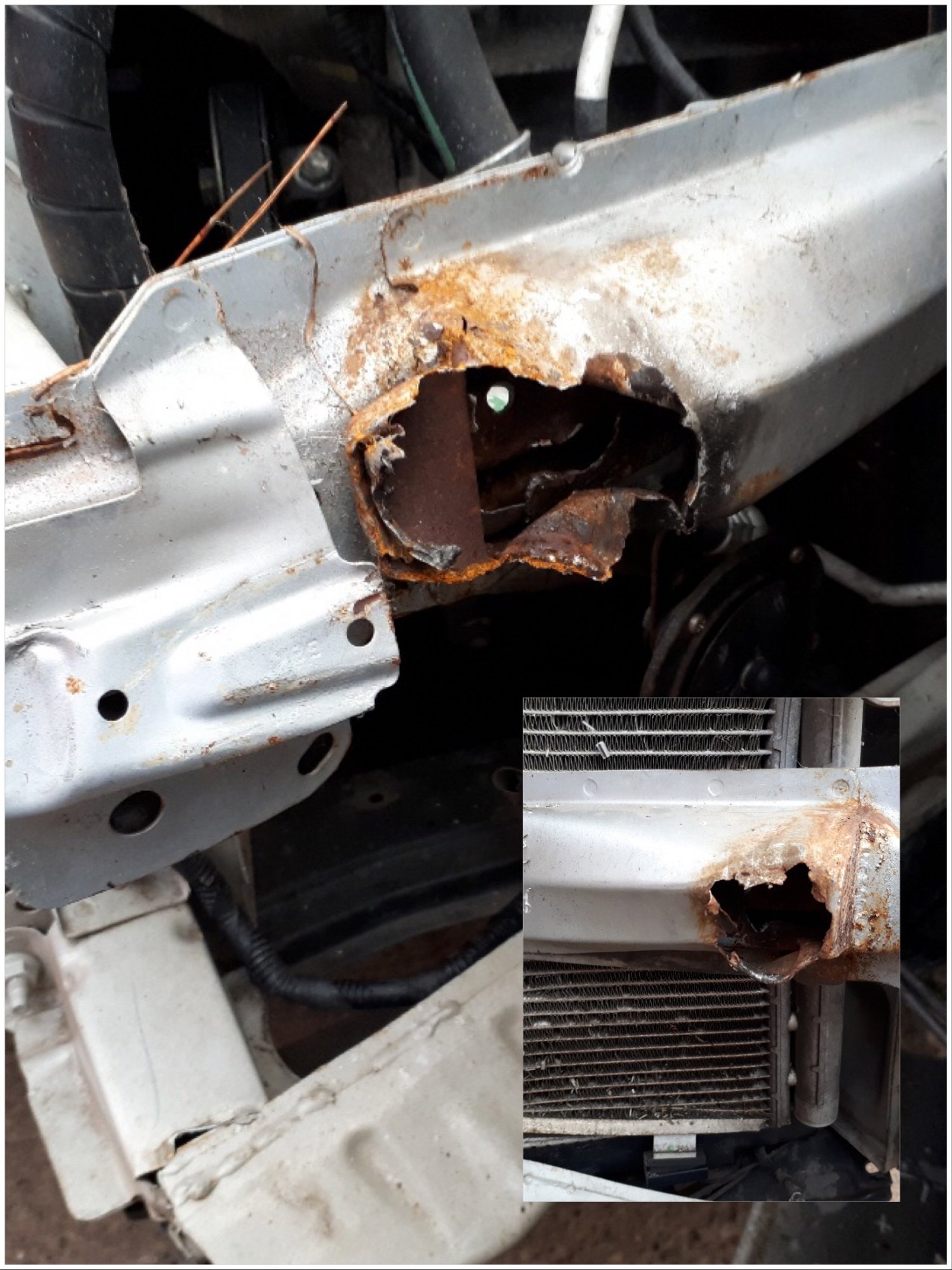

Already in the last 12 months, there have been at least 3 failures where either the towing eye(s) pulled out of the TOAD or the front crash protection collapsed. All were new (or nearly new) vehicles with less than 1000 towed miles. All these 3 cases are still ongoing.

Personally, I’d use a trailer! However, if you do go down the a-frame route, ensure you have a couple of hundred euros handy and, a second driver! Additionally, the front bumper needs to be removed annually for a full inspection of the mountings. As there are no standards or controls in place for a-frames, nothing can be taken for granted. ANYONE can have a go and fit one, no skill required.

Got a pair of Fiats 500's now, Wife's Red one she didn't want to leave in France and the white TOAD and a bigger Fiat to tow it with 😀
Lovely cars, Maggy has a 500 but she doesn't allow the dogs in it so I had to buy a Fiat Panda to tow, it has a top box and makes a great trailer behind the van 👍
That's a coincidence, Mary won't ever let the dog in her Red one either. Mind you it would be a bit squat if the seats weren't down 🐕🐶
