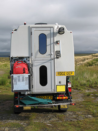

Hi Beemer. I have a suntrekker demountable and as you can guess its capacity is limited.
However, I carry a Honda gene on the back in a lockable case. It can be run from the case and also filled up without removing. The gene has a 12v socket which run some computer cooling fans which keeps the running temperature down when the lid is closed.

Just to give you an idea regards storage. I don't know if you have a reack at the back !!!!

.....and here's a close up in more detail.
Looks a brilliant job Journeyman. I sent a picture of boxes on a rack to Beemer. Hope it helps him.
Cool....
Nice van David, looks mint....:cool: and Journeyman, that's a good set up you have made....:cool::cool:

Journeyman, that looks a very well thought out container, do you get vibration problems through to the living space when the generator is running?

No vibration. Suggest you mount your gene on an anti vibe tray and if your gene hasn't already got them already, some rubber feet. How much air flow have you got in your ideal housing position?

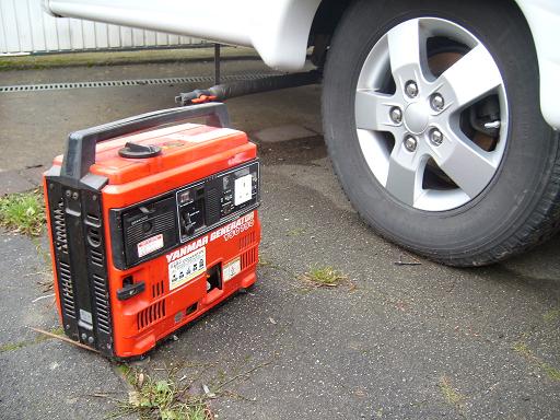

Have finally discovered the 'long' way round loading pics I hope!!!
I have three pics, one showing the old generator, one showing a side view of the 'van when it being prepared in the workshop (it is clearer to see how much room I have at the rear (under), and one showing under the back where the spare tyre is located, where I hope, perhaps to build a cage for the generator.

What is that box shape showing under the MH in your middle picture. Is it a locker space just like on the other side. If it is, perhaps something could be done with it. What is the height of the Generator?
The box shape is the locker on that side of the van, there is another one on the other side which are joined across the back of the van.
The generator will not fit into any of these lockers unfortunately, and I would still need to use the lockers for storage, hence the idea for the 'cage'.
