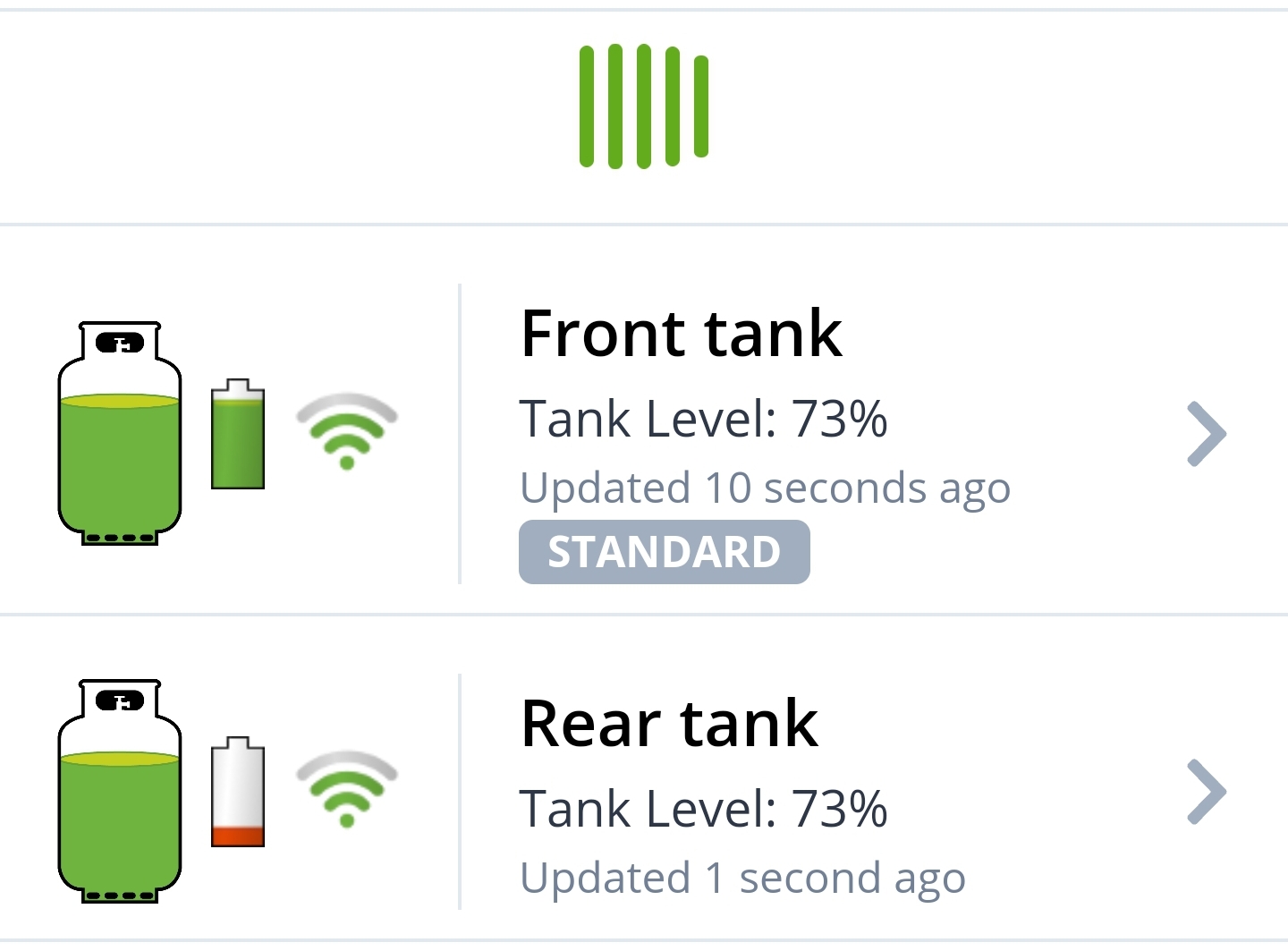

I’ve got one of these wee gizmos its came in handy a few times.
I just look on my phone ;-)
