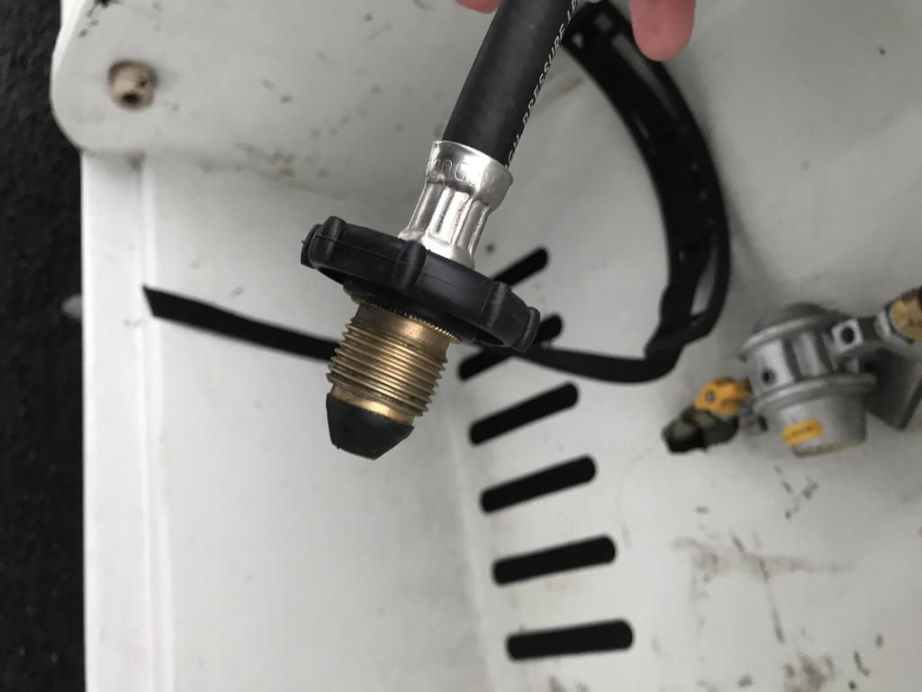

Would you normally have that stop tap on the van side of that regulator? Will get another look when the snow has gone later in the week and hopefully see a bit more
ok so you can disregard the gaslo point until/if you decide you want refillable the tail from the regulator can be bought to suit whichever bottle you have will normally tell you on the knurled nut end,
