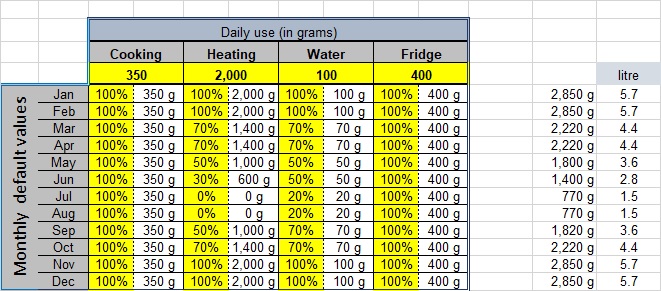

The most I've ever used in a day is about 7 litres of gas. That was in extreme cold with the heating on at a normal temperature during the day but turned onto its lowest setting overnight.
These are the figures I use to estimate gas use in the UK.
