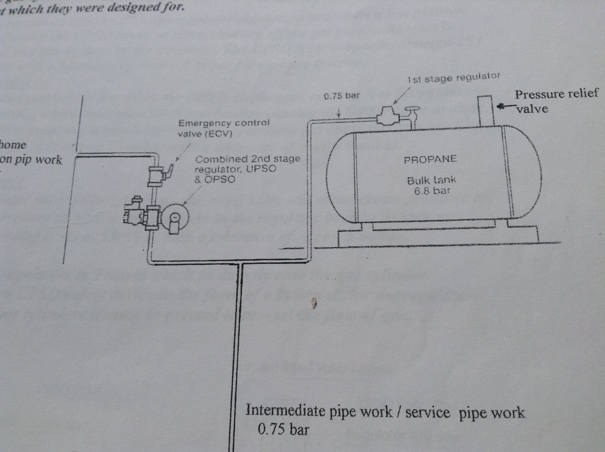

Sharpie elsewhere you accuse my post re a Ecv further downstream as dangerous .....do you have the legislation ,gas installation section that categorically state that ,? I think merely expressing a personal opinion ?
What I can tell you as I mentioned on a bottle of gas the bottle valve suffices as an Ecv ...the problem becomes when more than one bottle or a tank is employed.
The gas safety regulation s of January 1996 state on a multi cylinder arrangement the Ecv will be fitted directly after the regulator the gas safety regulation 9 (5) requires the use of separate emergency isolation valve where 2 or more cylinders are used at the same time ( auto shut off type arrangement)
The problem with this isn't unlike a bottle valve killing the gas at source there is still part of the system live
Every and I mean every fixed bulk system I have worked on has had the Ecv post 2 no stage regulator , no exceptions that I can recall,, because isolating a under slung tank is not always easy to turn off or practical in terms of safety and time taken an isolation valve fitted as soon as practical within the system is sufficient and I can't anything that contradicts
I have enclosed a schematic of a typical bulk installation which although static by nature consideration as an installer needs to be giving from perils such as vehicle impact proximity to drains opening windows etc
Schematic
Channa, I'm not sure how much read-across there is between a static installation and that in a vehicle..
You may be technically correct in saying that just closing the appliance isolation valves is considered sufficient. My van has three of them. Is that the same as a single ECV ?
An ECV is for use in emergencies. Not routine use. It's there for if e.g. a house catches fire and the firefighters need to go in. They'll turn it off first.
