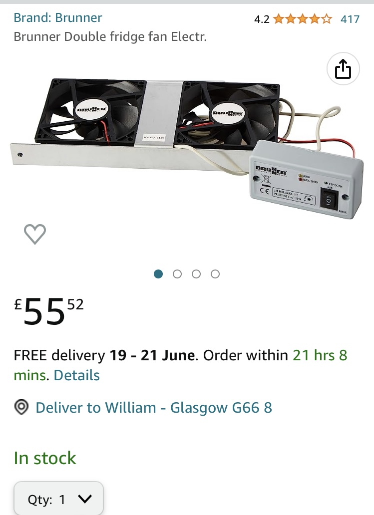

I installed the Titan fridge fan kit in my motorhome.
It is not a bargain option compared to an old computer fan but I think is a lot more capable with built-in temp sensor giving variable speed control in auto mode plus 4 manual speed settings. Nice bit of kit and happy I went that way instead the DIY route.
I have 2 X 120mm 12v super silent computer fans installed on the top fridge vent blowing outwards and we`ve had them running all night as well.
The fridge is coping well with the crazy temperatures down in Canterbury then 32C in Eastern France and now 29C in Luuxembourg 😎
I already bought this David
