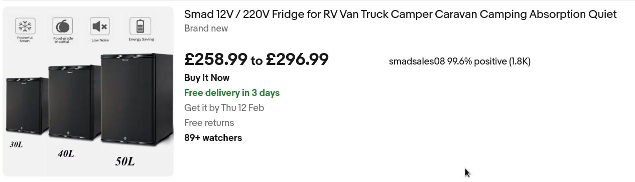

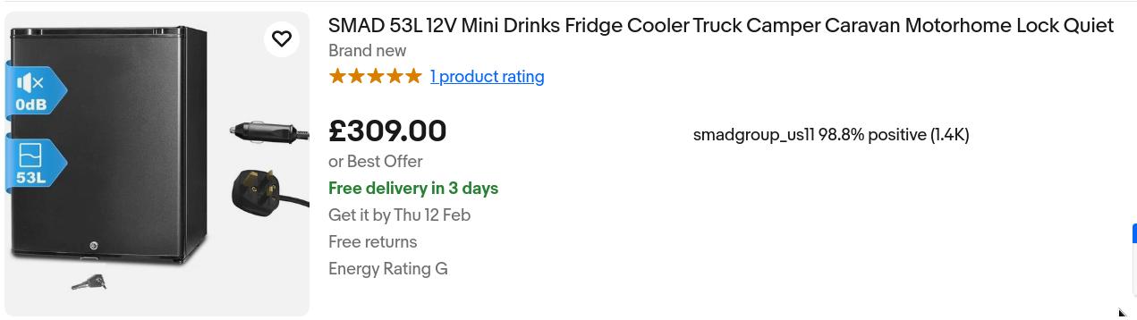

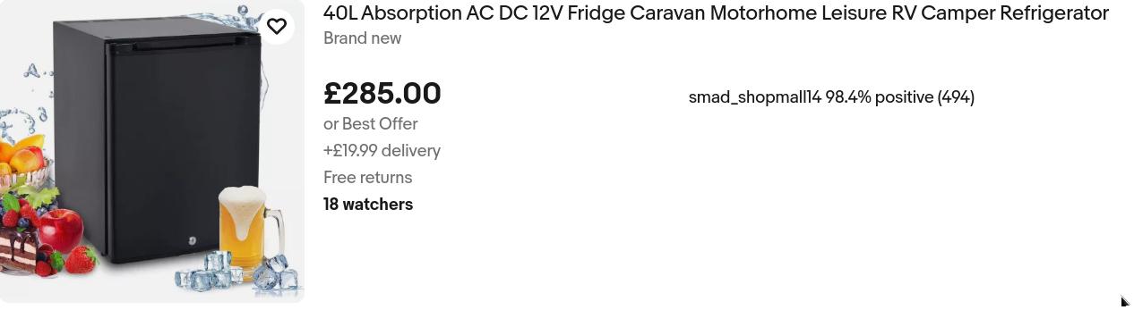

12v compressor fridges from around £300, back pocket money. ;)
