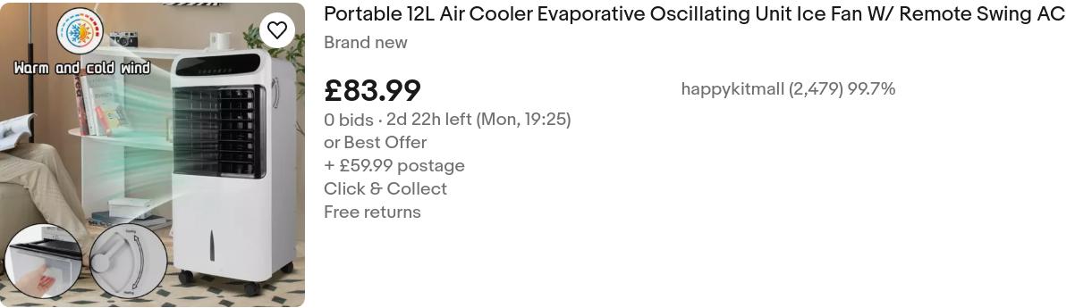

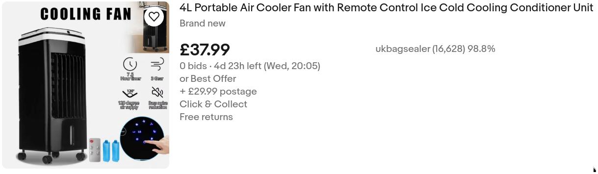

Fan been on in my living room all week, and its a big one, did it make any diferance, no and even with the front door open, 23c inside and 17c out side.
AS i said a cooler unit behind a fan makes a big differance, i think you can buy these units for home these days.

a) was the fan blowing air out of the open door?
b) was there another opening so that cool air could get in?
To use a fan to cool a room you need to have two opening and place the fan to blow air out of one of them.

AS i said a cooler unit behind a fan makes a big differance, i think you can buy these units for home these days.View attachment 133527View attachment 133528
If it's cooler outside Trev you need to place the fan in the doorway or an open window, that way it will draw in the cooler air from outside rather than try and blow the warm air out.
In that respect it should work on a 'fridge if placed correctly.
