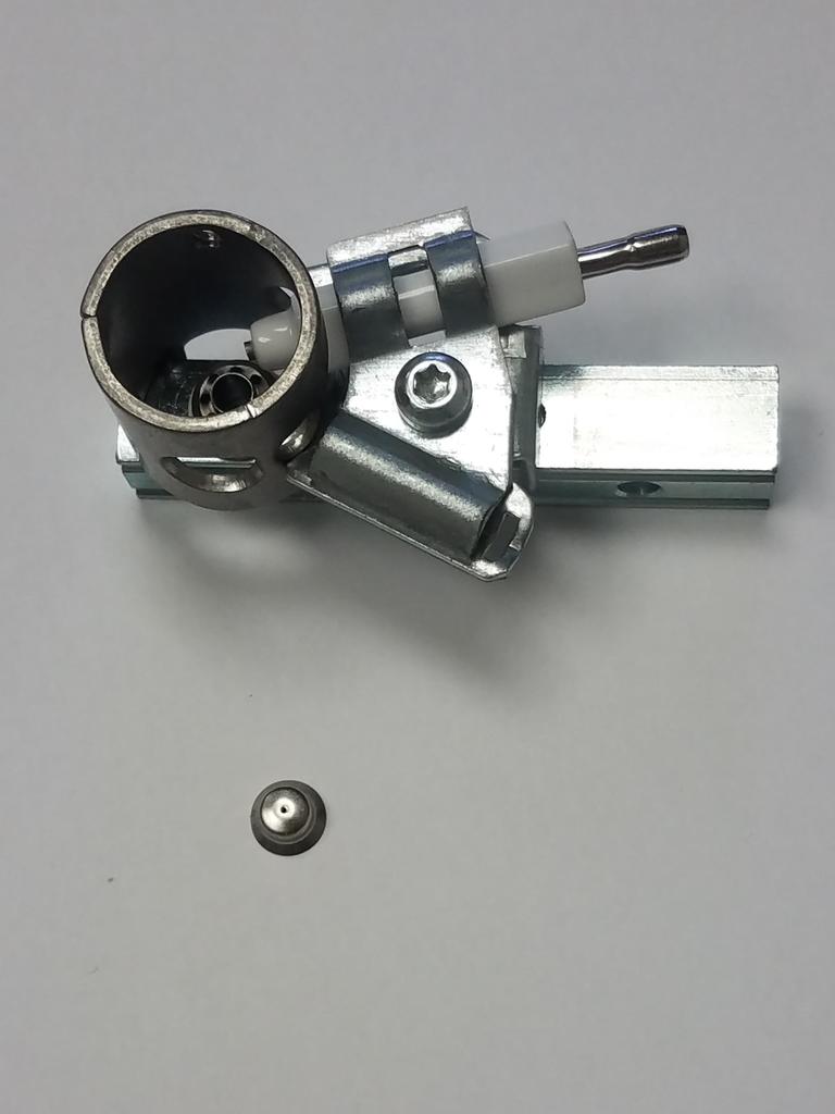

i had trouble with mine. i pulled the fridge outand extended the gas pipe
with some tube so i could see the flame with the cover removed. the flame
looked a bit small even after cleaning so i removed the jet and cleaned the
burner behind where the jet sits it was rusty. i fitted a new jet cost £8
the flame seemed to be a lot larger. it could have been a different size jet
though because i dont know what model fridge it is no numbers. while i had it
out i fitted a small fan to the fins on the back to help ventilation. there was a
vent on the back of the van under the rear light not being used so i opened
it up a fitted a grille, it works perfect now even without the fan. last month
i had it turned to no 2 on the controller and it was still 4 deg c
