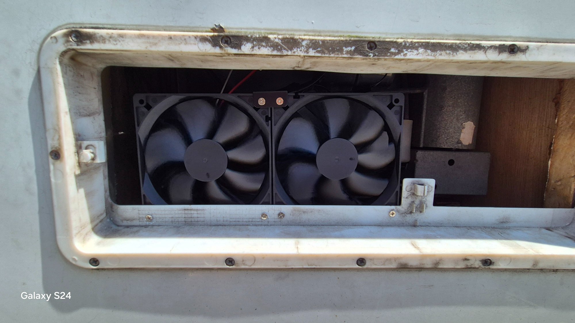

I then set about fitting the two large computer fans into the bottom vent area.

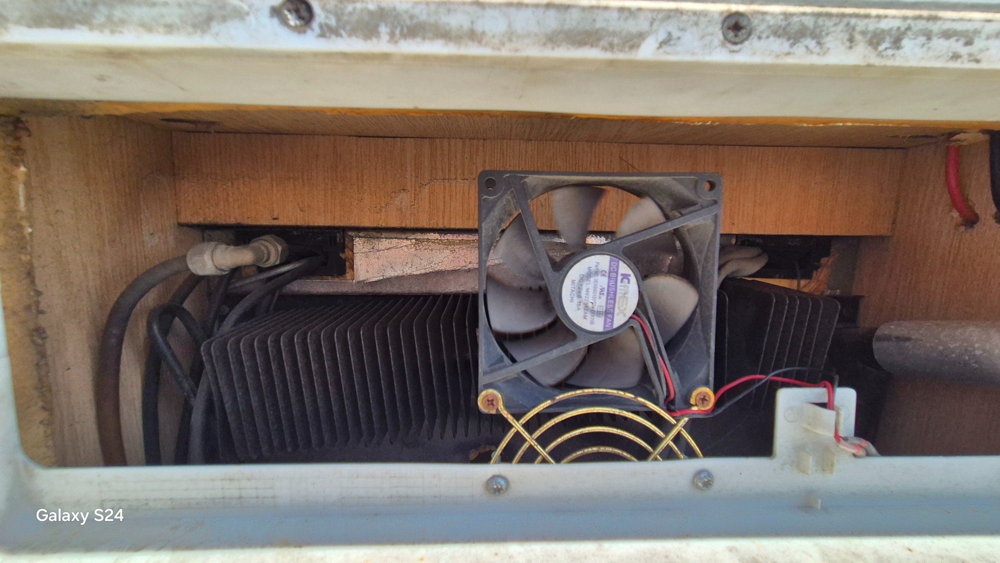

(See photos) I had already fitted a single small fan at the top vent some years ago.
As can be seen the bottom fans where their mounting holes were, I drilled four holes in the lip of the inner vent mount then used the supplied set screws to screw the fans up against the inside vent.

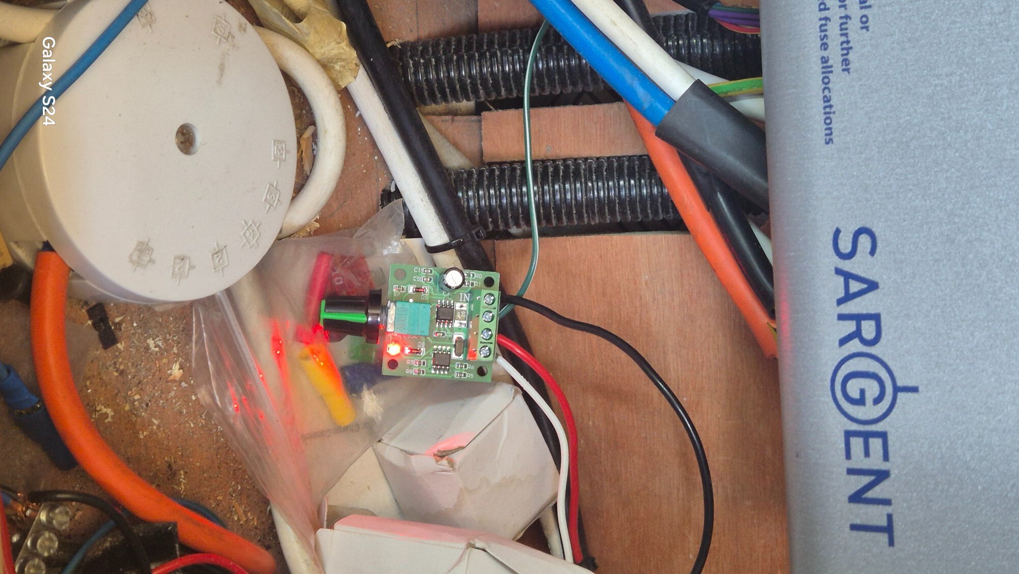

Then the wiring which I had brought through the wall from the fuse box area to supply the top fan was cut into and put the bottom fans into parallel. Had used the external pump wire from the Sargents unit to power the fans and put the 12v controller in series wit this wire and so could controll the speed of all three fans simultaneously. The added bonus is that on the Sargents 328 control panel I can have either the internal pump going/External pump going or both at once and so just by touch I can turn the fridge fans on and off.
The 12v controller I will eventually box up and fit it nicely inside the electrics cupboard ( Sometime
I have put the fridge on gas and the external temp here in Barry was 32°C within 20mins the freezer side had ice on the vanes and the general fridge vanes were cold to touch so I'm hoping that it is actually going to improve the fridge efficiency by leaps and bounds, we shall see, we're of to Southern Ireland on Monday let me hope the weather stays hot and I can test the theory in practice.
