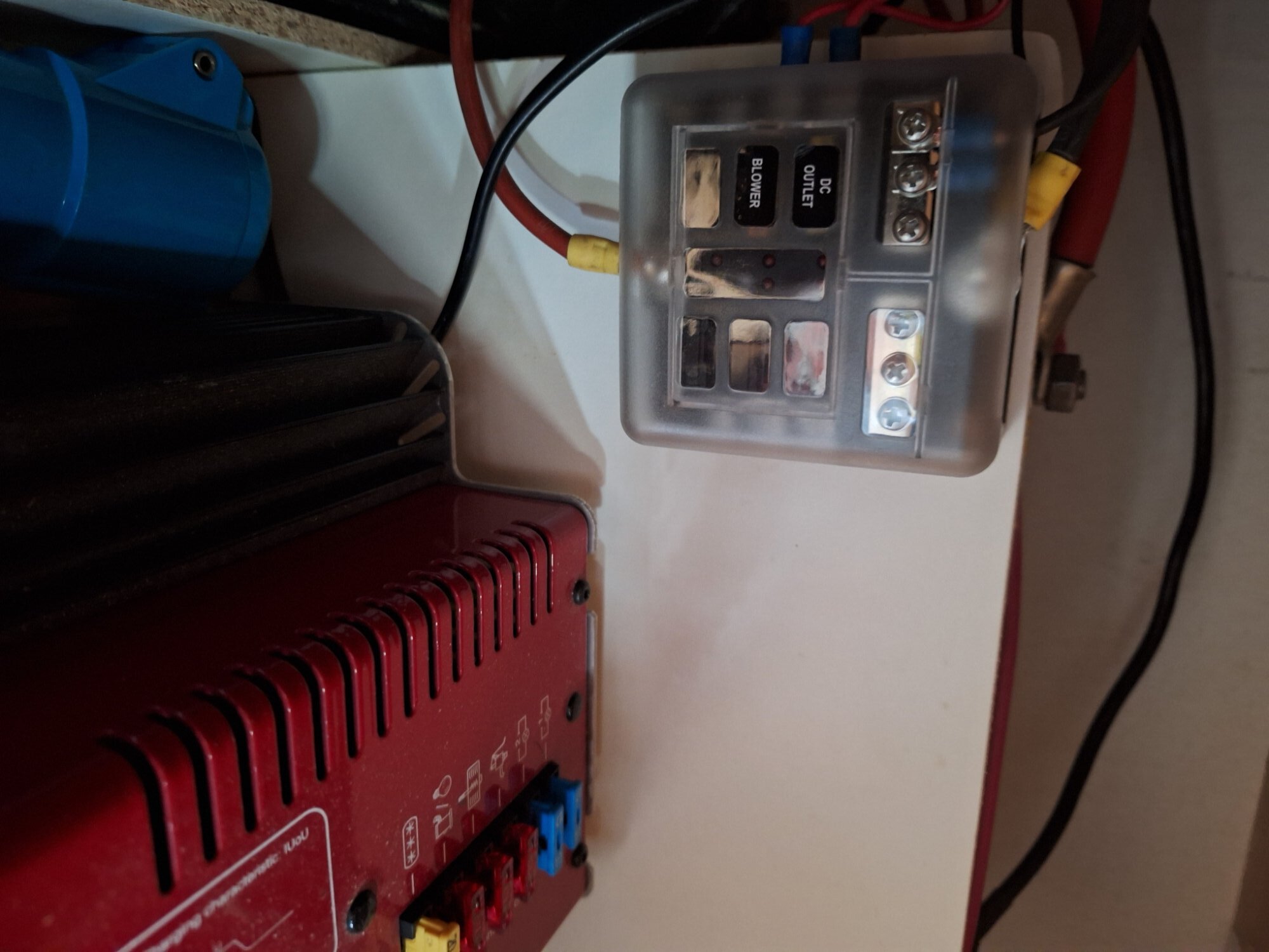

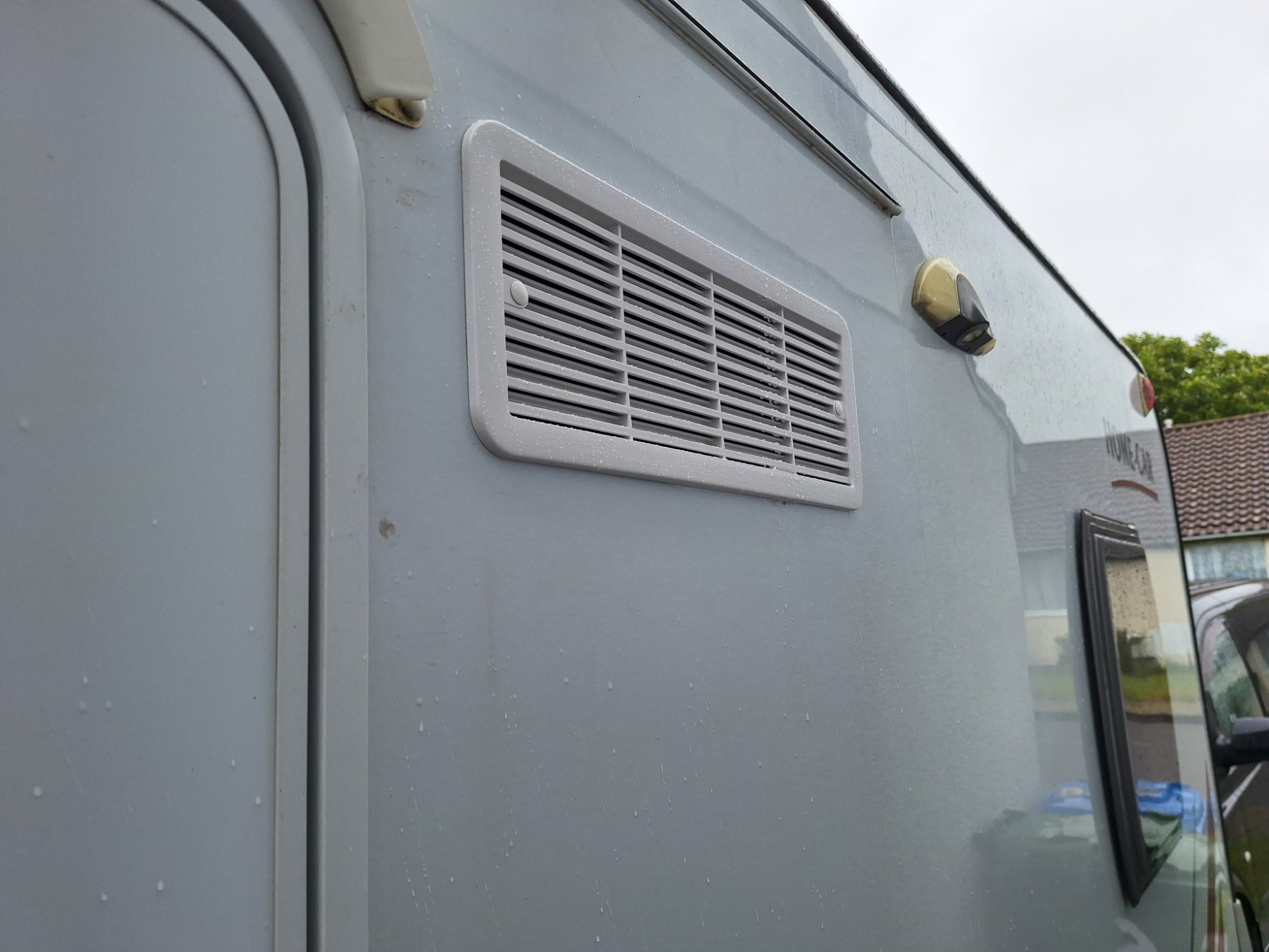

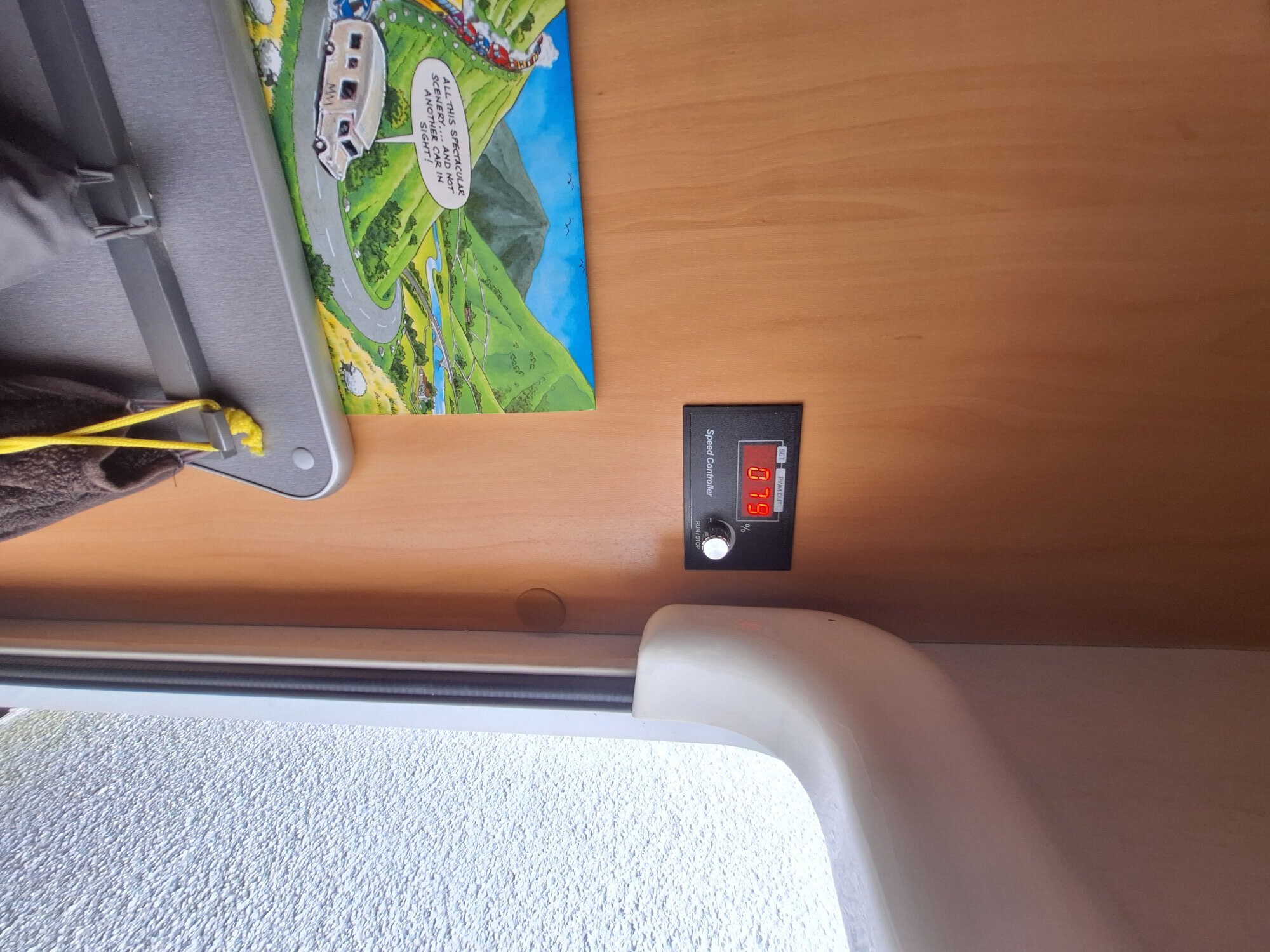

Finally got round to fitting the fridge triple cooling fan unit. The unit itself was pretty much a straight fit. Little bit of filing but not much. The speed controller works well but has a tiny lip so accurate hole cutting needed. Rather than fit an inline fuse I added a new fuse panel so any further additions can wire to that. Wiring in 2.5mm twin came down the back of fridge space, through the under cupboard, through an existing grommet in the floor, under the van in conduit clipped to existing loom under door then up through the floor into electrics cupboard. Fairly easy days work
