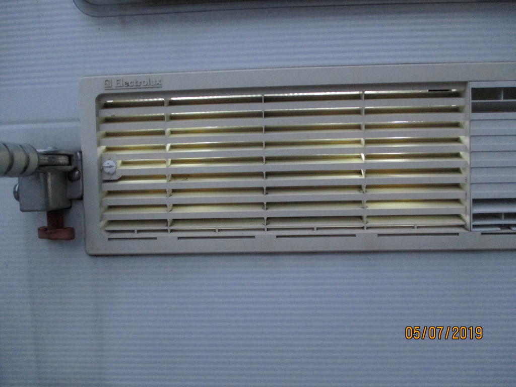

It's just occurred to me that this might be a use for the unused "load" terminals on my MPPT solar controller - but having googled it, there are differing explanations as to how the "load" supply works, with most saying that it's not of any use in the motorhome.
If it is supplied from the unused energy from the solar panel after fully charging the batteries, which would otherwise be wasted, then it seems to me it would be ideal for powering the fridge vent fan, as it would be available during periods of sun when the ambient temperature is likely to be higher. However, if it's going to reduce the charge going to the batteries, or even worse use some of their power, it's probably not a worthwhile option.
Perhaps some of the knowledgeable contributors on solar could advise?
No reason why not but it just complicates things a little. The fans you fit will take hardly any power. They can however be noisy especially on full power. So I have a switch on mine which can switch them on, off, auto and half speed. On half speed you cannot hear them running but they do increase the flow of air through the back of the fridge. If you play around with resistors in the circuit you can have them running at half speed or you can wire them in parallel with each other or series. If you cannot hear them running on full power then just switch them on and off or do it automatically and try something like HERE
