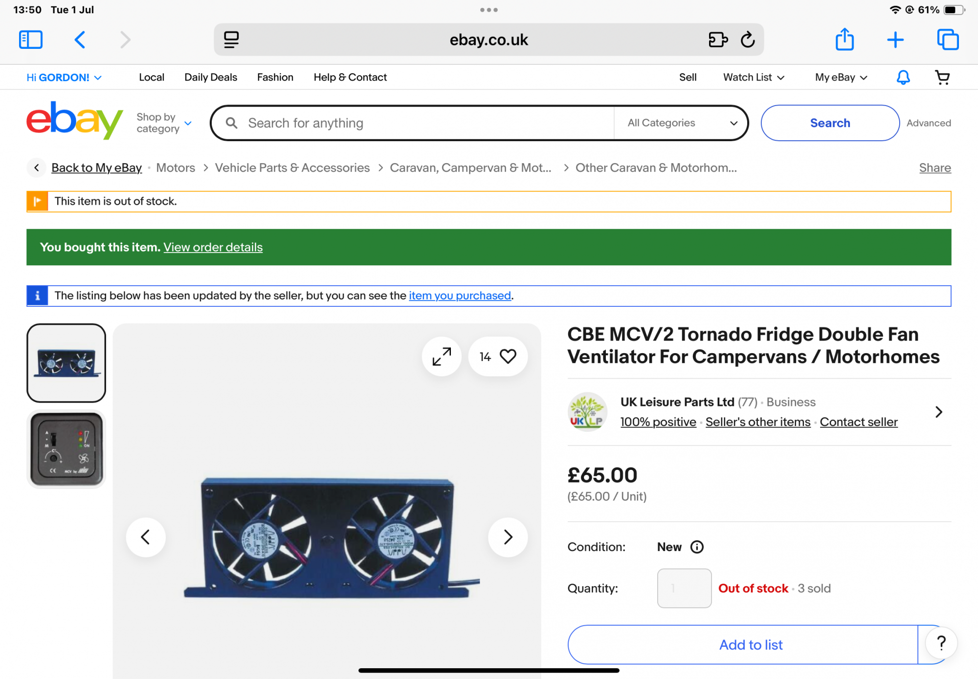

This is the same as we have fitted. It wasn't a cheap option, but I just didn't want the faff! And it comes with an auto option through the temperature sensor, so we just leave that on when it is hot.There have been a fair few posts on this subject, mostly with people fitting a 12V fan sold for PCs along with an on/off switch to control it. That is definately the cheapest way to get some forced air into the back of the fridge.
