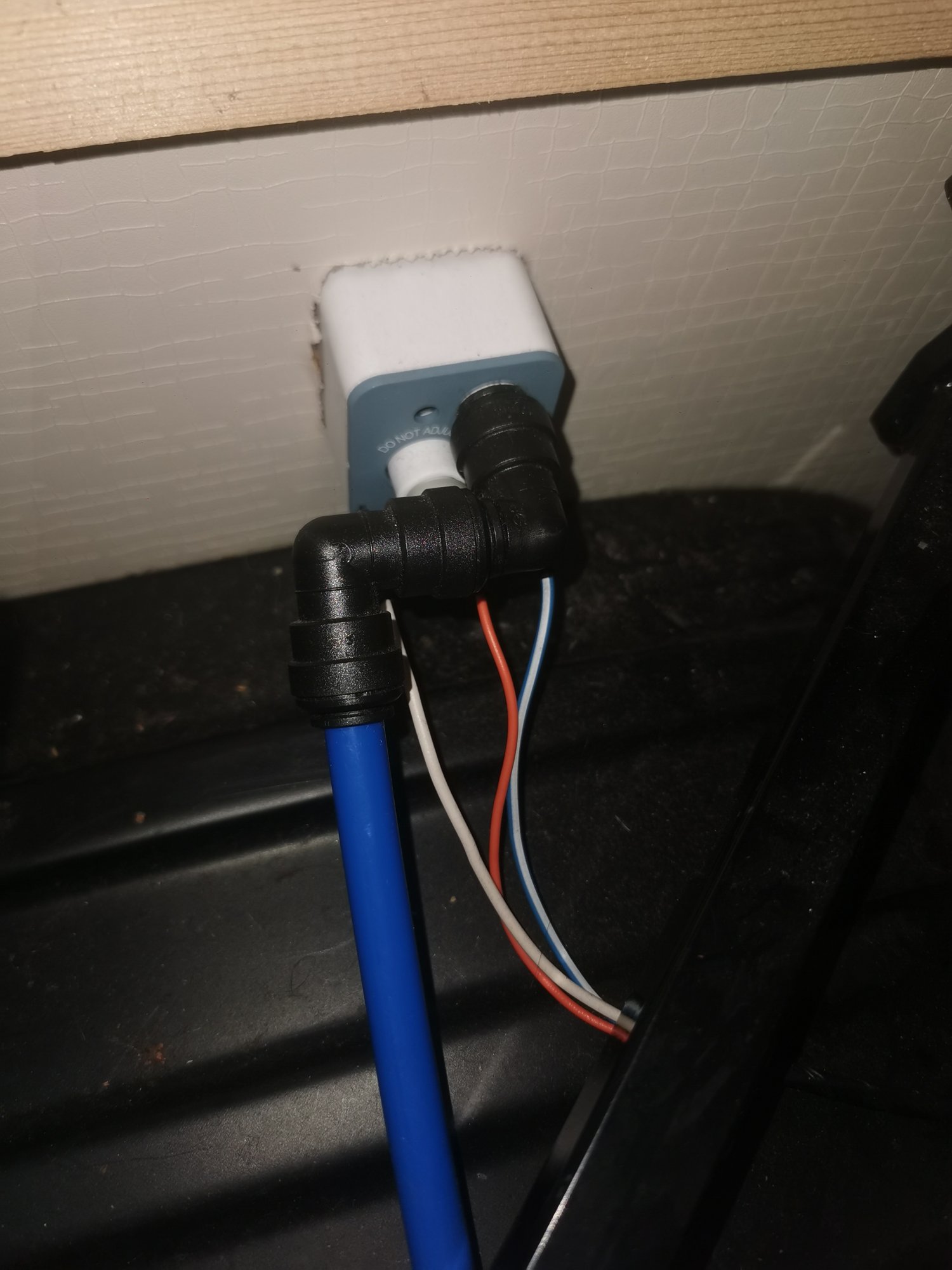

Just found this in the AutoQuest manual.
First question. "Is yours the same"?
It isn't clear if the connection between the float and the valve is electrical or mechanical.
I've never encountered this system before and know nothing about, but it seems straightforward.
However, the diagram showing filling / topping up from an external tank shows the pressure switch controlling the 12v to the submersible pump.
This means the valve must be closed to allow pressure to build between the sub pump and the valve.
Which tends to imply the Float valve is mechanical. (Otherwise they could use the float to control both the valve and the pump.
If it is mechanical please ignore my previous post and examine this connection. A bump may have caused misalignment.
If you can't spot a problem some photos will help us.

Thought I would post a couple of pictures for more information. First pictire shows the external water inlet from the inside where solenoid is. Second picture is a valve which I presume is cutting off the power supply when signaled from the tank. (too early in my case). Would it be worth starting another fill of water, disconnecting valve and see if it gets beyond the third full?
