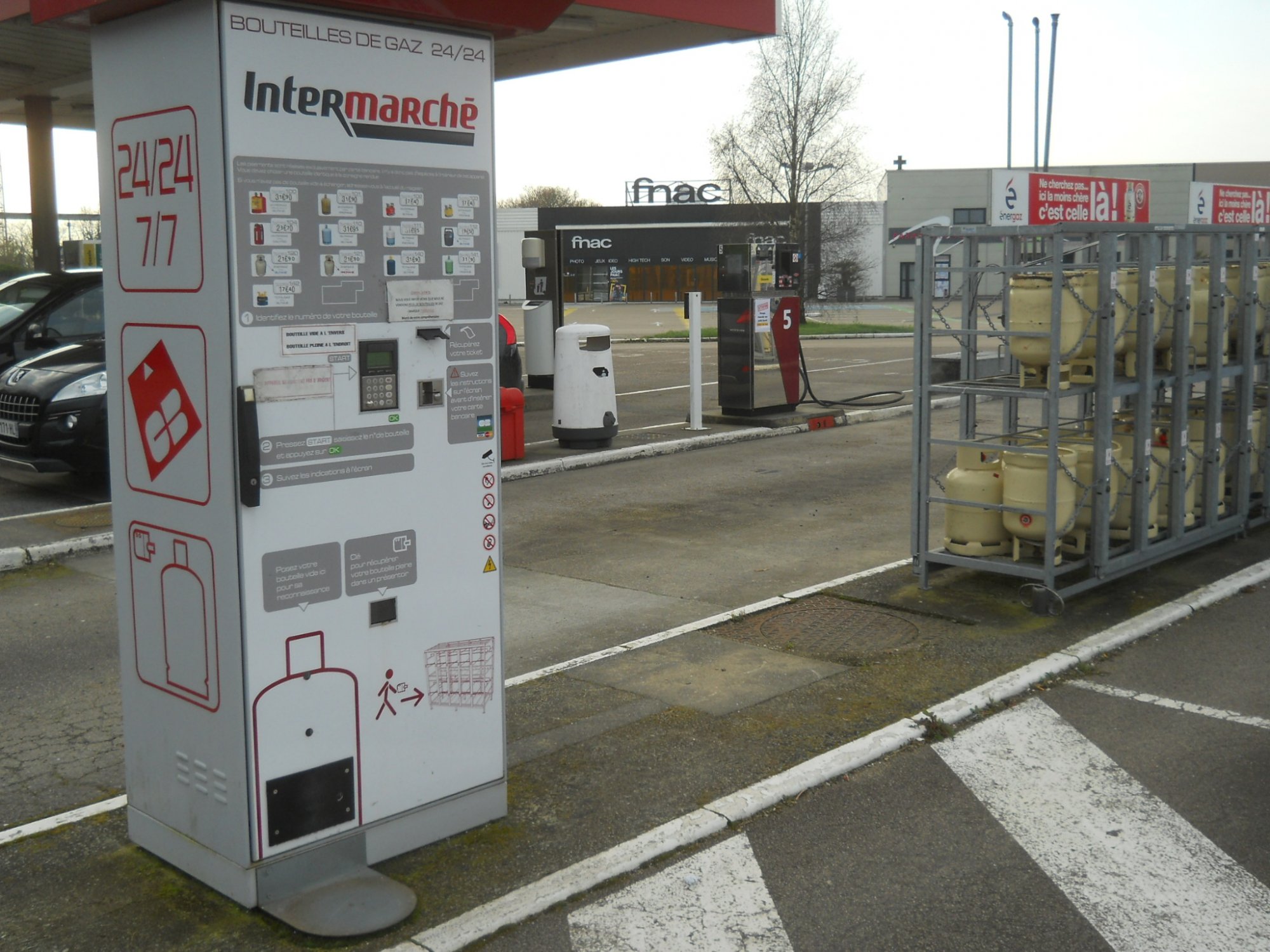

I've never used other than French propane in exchange bottles which Ive obtained from the Intermarche supermarket chain. You just need one of these to adapt the UK propane to the french bottle
This is the 10kg bottle 2 yrs ago it was 22€ with 3€ deposit after you have a bottle there are self service racks at many locations

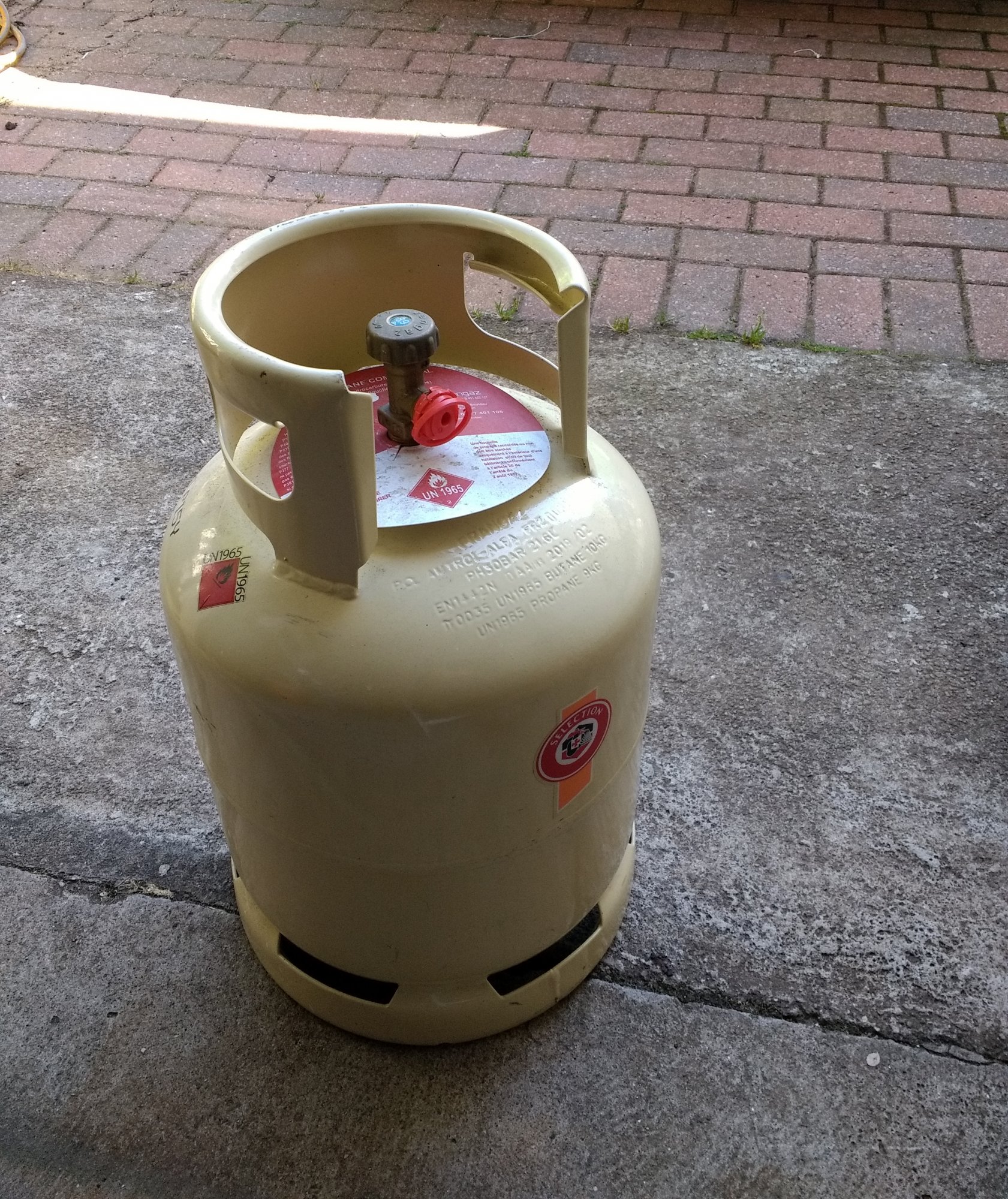

As for Spain bottles are not so easy to get there so he'll need to look out for a empty bottle at boot sales Repsol or Cepsa are the most common but he'll need another adaptor I carry 2 French bottles so one is always full when I enter Spain
Heres a photo of spanish bottle with the jumbo adapter
And the adaptor
