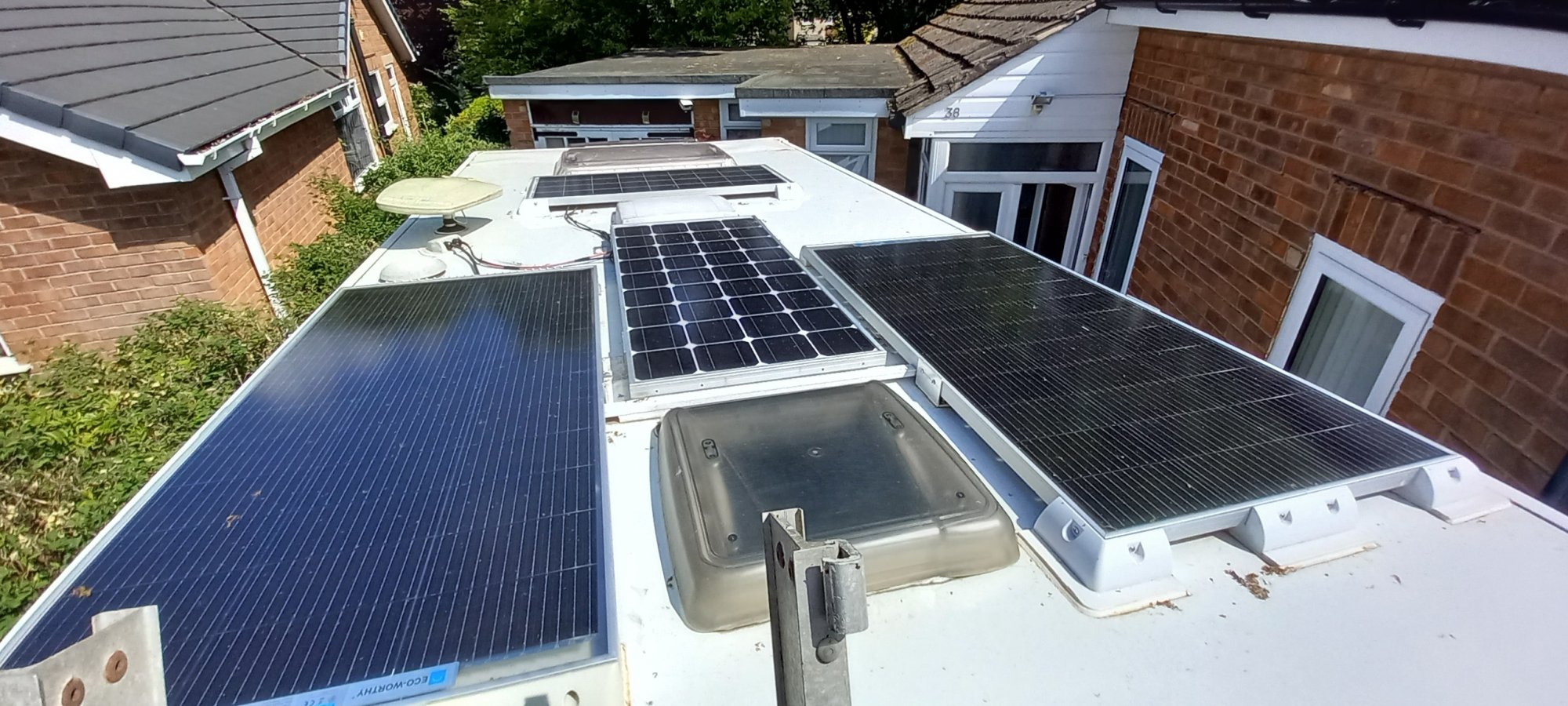

Quite surprising what you can squeeze on the roof of a van
With the big lump at the front of my Motorhome, I only have 3.5M of flat space available. Take away a large rooflight and two vents plus a satellite dish, then a Terrestial TV Ariel and 5G Antenna and still room for 450W of panels.

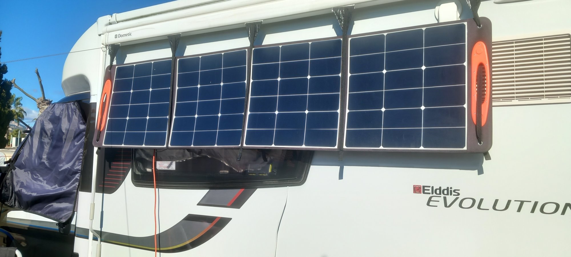

Same really with portable panels. I did have a set but after going to move them every 30 minutes to optimize the harvest .... nah, not for me.
