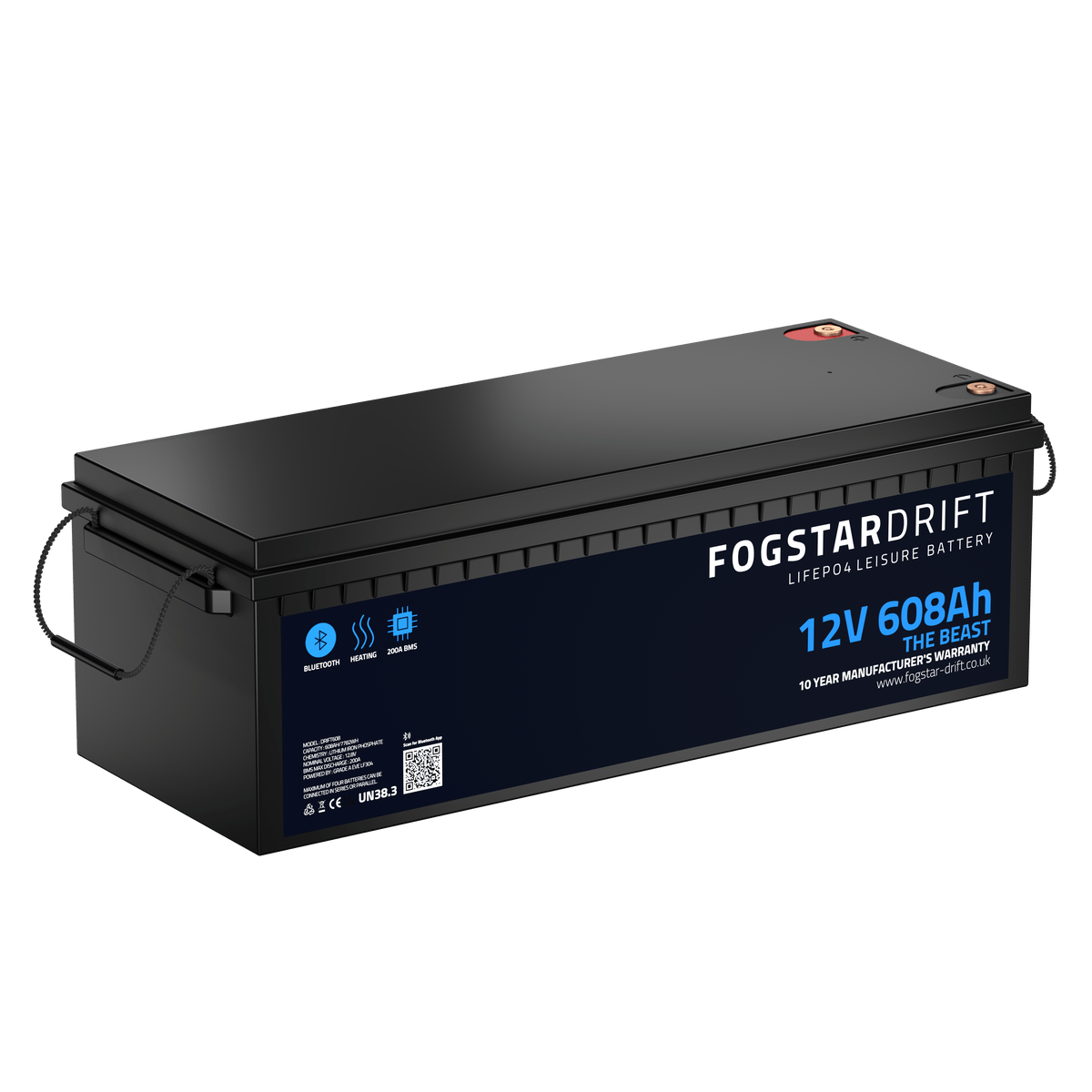

Here are the details from their website: This battery is on sale below their trade price.
12.8V 608Ah Lithium Leisure Battery, an exceptional power solution that seamlessly adapts to a diverse range of applications, from solar energy systems and boats, to campervans and caravans.
Our 608Ah Drift battery, affectionately named 'The Beast', offers an incredible 7782Wh of energy from a full charge, surpassing the needs of even the most demanding off-grid adventures.
Backed by a 10-year warranty and supported by a UK-based team, it's designed for long-lasting performance and reliability.
  • Designed & Supported in the UK: Expertly designed in the UK with a dedicated UK-based support team for complete peace of mind.
  • Ultra-Long Lifespan: With an impressive cycle life of 3,500 cycles at 80% depth of discharge (DOD), the Drift 608Ah offers years of dependable performance, lasting 10–15 years.
  • 10 Year Warranty: Backed by a 10-year warranty, ensuring long-term reliability and peace of mind.
  • IP67 Rated: IP67 rated for dust and water resistance — built to withstand the toughest off-grid, marine, and outdoor environments.
  • Premium Lithium Cells: Manufactured using Grade A EVE LF304 LiFePO4 cells for exceptional safety, stability, and long-term performance.
  • Advanced 250A BMS: Equipped with a high-discharge 250A JBD Battery Management System, ensuring optimal power delivery and protecting battery health from start to finish.
  • Bluetooth Monitoring: Monitor and manage your battery in real-time using the free Fogstar Drift App (Android & iOS).
  • Built-in Heating: Integrated automatic heating system maintains peak performance even in cold environments.
  • Lightweight & Compact: Weighing only 48Kg and measuring L(640mm) x W(245mm) x H(220mm), this battery features robust lifting handles for easy installation and handling.
  • Expandable Power: Connect up to 4 Drift batteries in series or parallel for increased capacity.
  • Inverter Ready: Perfect for use with larger inverters and high-demand setups — handles heavy-duty applications with ease thanks to its robust 250A BMS.

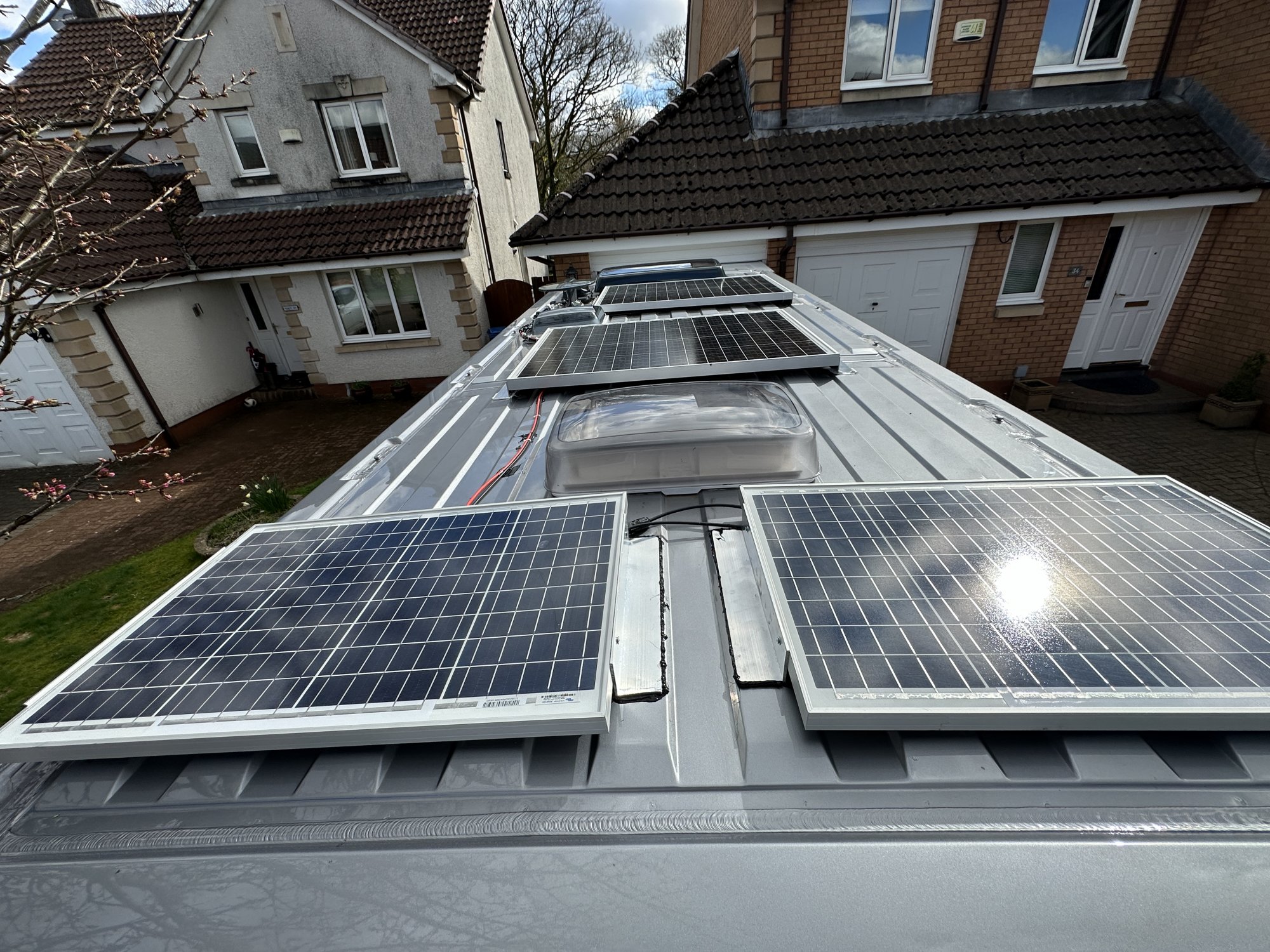

Mark I only have a 6.3m van and I have 330w of solar.
Two 120w and two 45a victron panels at the rear.
Can you not add any.
