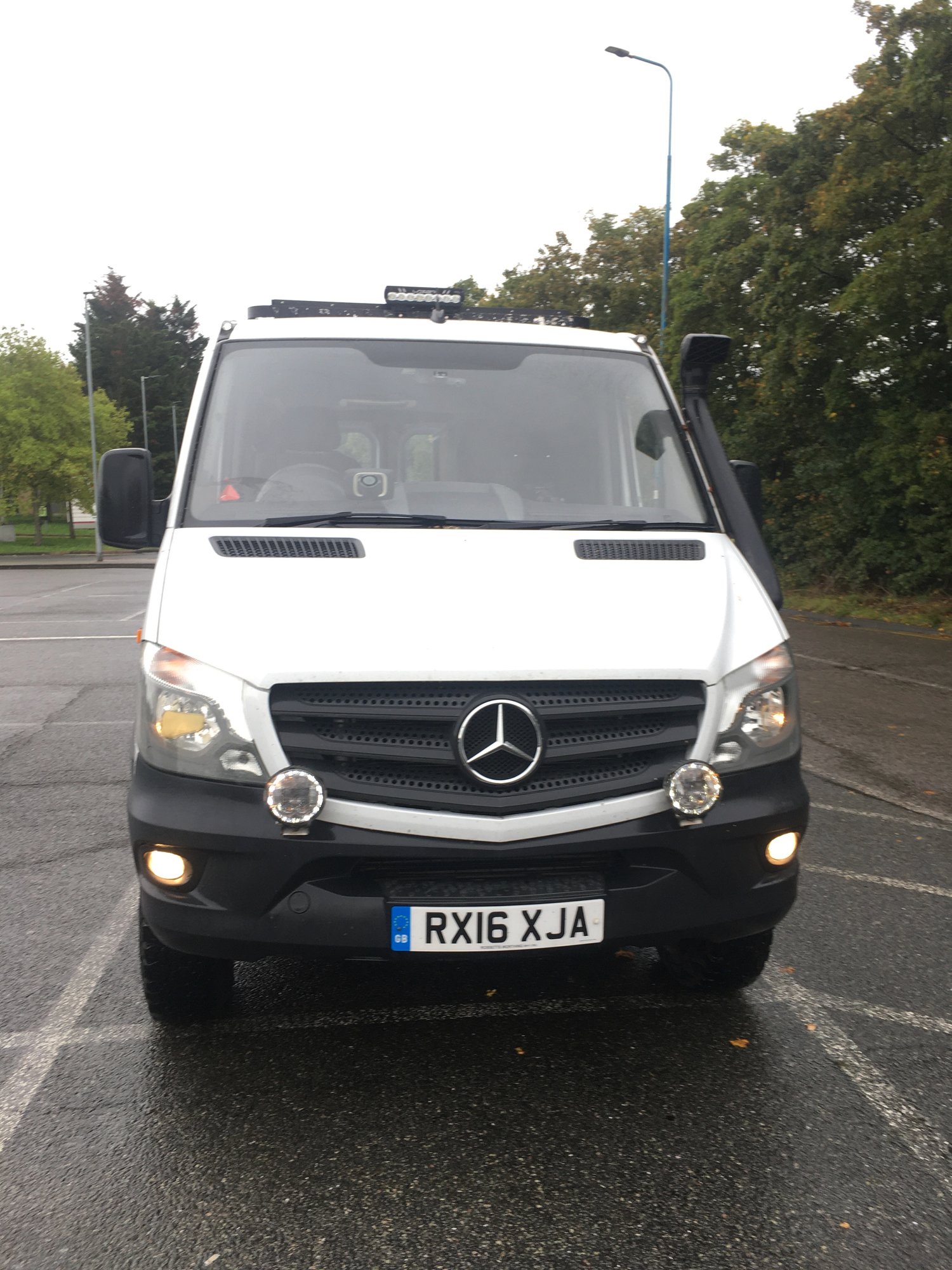

Finally got around to wiring up the fog lights on the motorhome today. Spoke to Phil at Kelso and he suggested using a piggy back fuse holder. Also stated they should only be able to be switched on when the dipped lights are illuminated so plugged the holder into the dipped light fuse. Cheers for the recommendation using the piggy back thingy was a much simpler solution than hard wiring.👍
Wonder if I can make a claim against Mercedes. :D
Factory fitted fog lights work with just side/position lights on, although the cornering function only works with dipped beam.
And any excuse for a pic. :p
