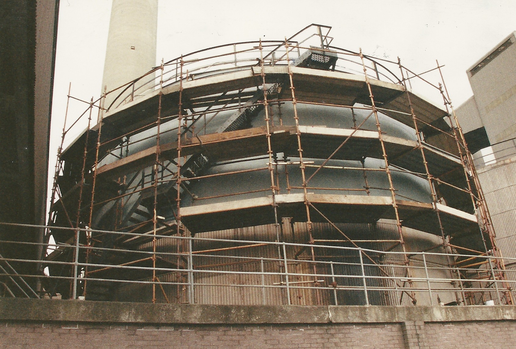

Clor rubber paint is ok but not foolproof, and its a single pack, we used it mainly for outside of tanks but would line the inside with epoxy or grp depending on the use, a small one I did.
