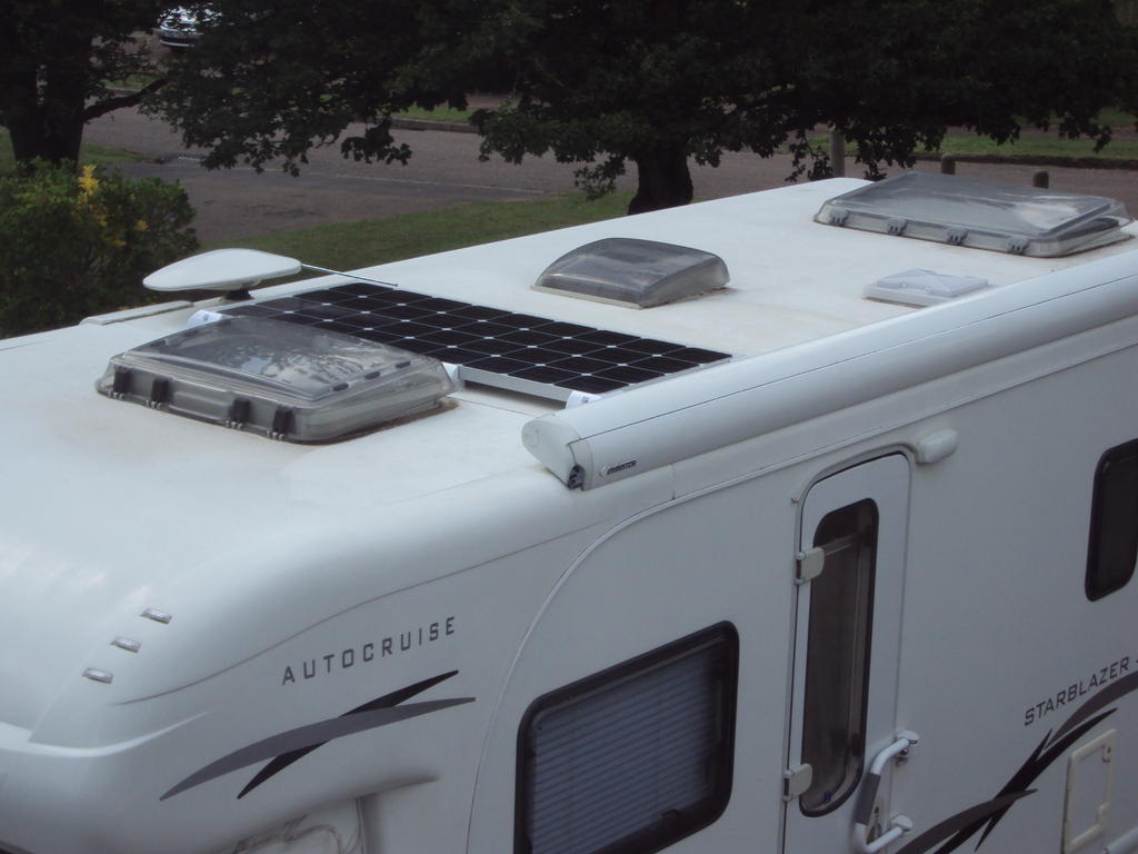

So I got some riv nuts M6 aluminium and a cheap setting tool of eBay. Now for tools I use every day I buy the best I can afford, but given that these would most likely not see much use after the solar panel install I thought the £11.99 plier type would do for the dozen riv nuts that were to be fitted. After the fifth rivet was installed the part inside the plier that pulls the back of the rivet up started crunching and crumbling away. What a piece of absolute rubbish this tool is. I wasn't expecting much for the price, but 5 soft ally rivets and knackered. Anyway I managed to bodge the pliers up by packing it with a washer with a slot cut out of it and the riv nuts are all fitted. I did use the idea of filing a small notch in the side of the holes using a small triangular file. Good idea and could make all the difference if I ever have to undo the bolts again, so thanks for that one :cheers: .
So brackets all fitted, just need the bloody rain to stop for a while so I can get the thing on the roof.
One more question. Would methylated spirits (the purple type) do for cleaning the roof and the mounting bracket feet before putting the Sikaflex on?
Thanks to everyone who has helped so far.
I'm waiting for this chuffin drizzle to stop so I can dry the roof, clean/key up the area with white spirit & Sikaflex the brackets onto position They are already mounted onto the Solar panel. :juggle:
Thank you. But maybe fitting it on St.Swithans day wasn't such a good idea? Ha.

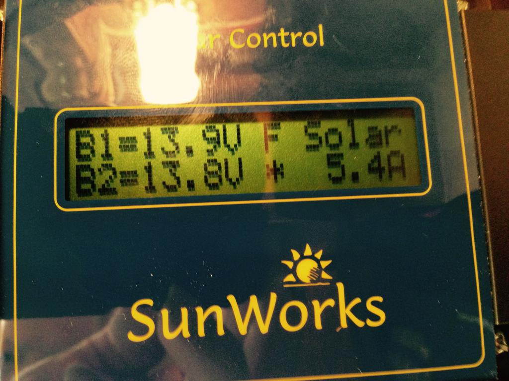

Solar panel fitted on roof eventually and all connected.. Seems to be working well. On a dull overcast morning at 7.45am it was generating 0.9 amps, 2 hours later still overcast it was at 2.1 amps and with a glimmer of sun 5.4 amps. Both battery banks are now sitting on float charge at around 13.6 volts. So I think it's all working as it should for a 100 watt panel. Unless someone tells me differently!
