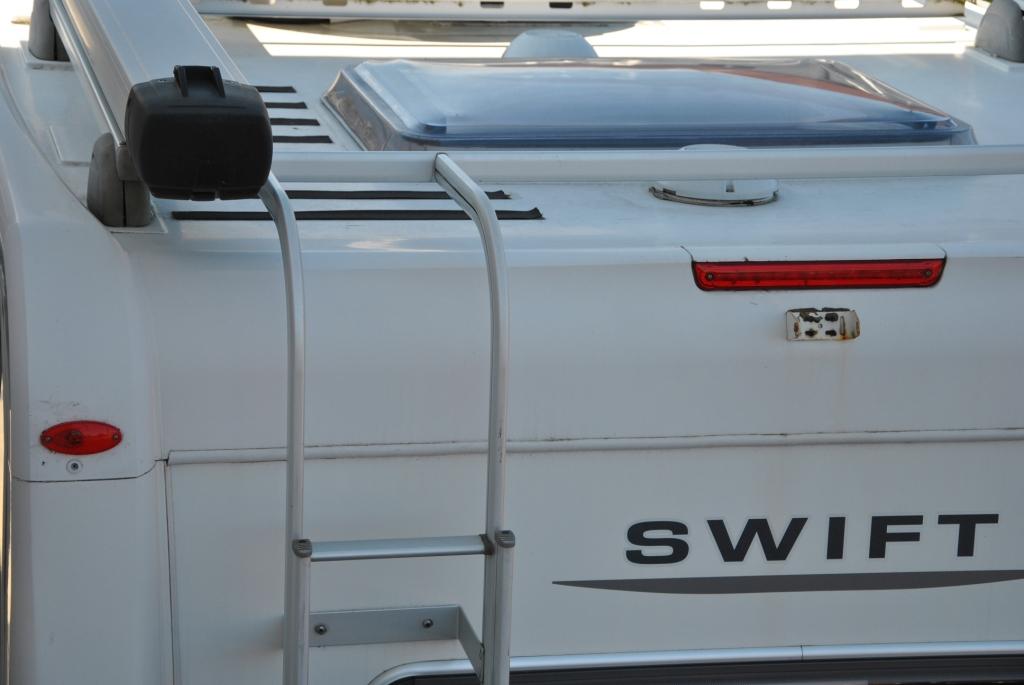

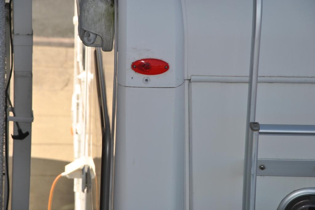

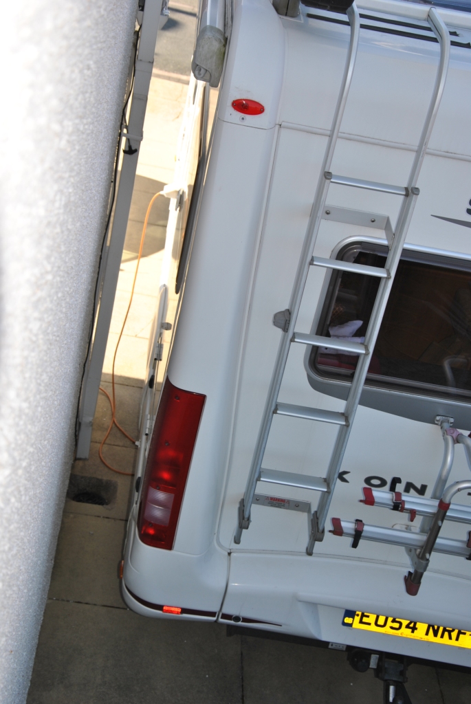

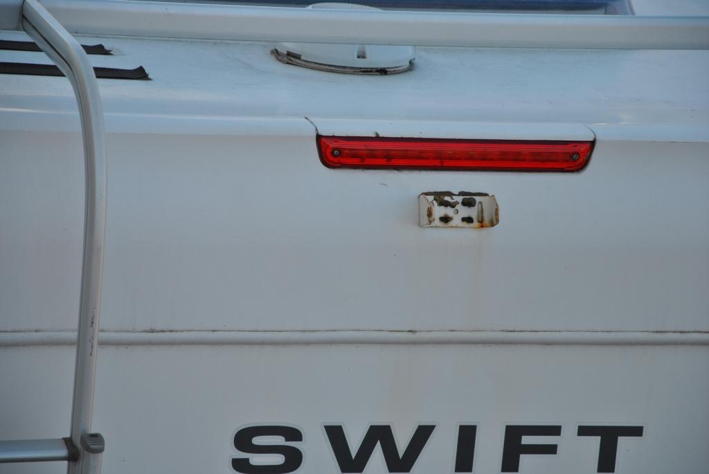

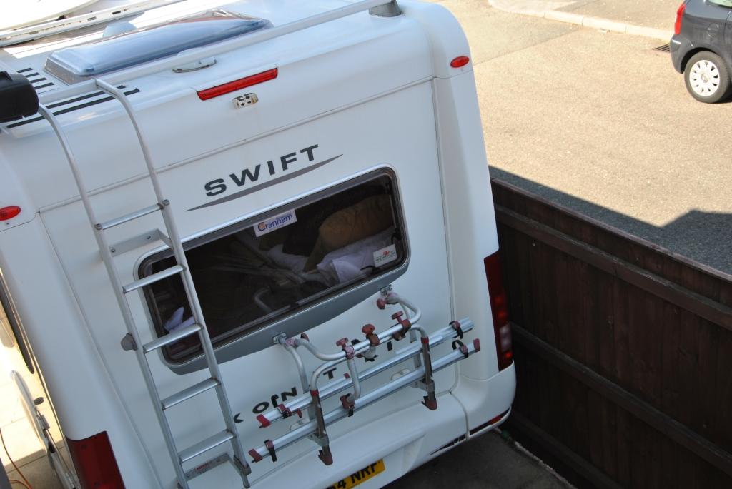

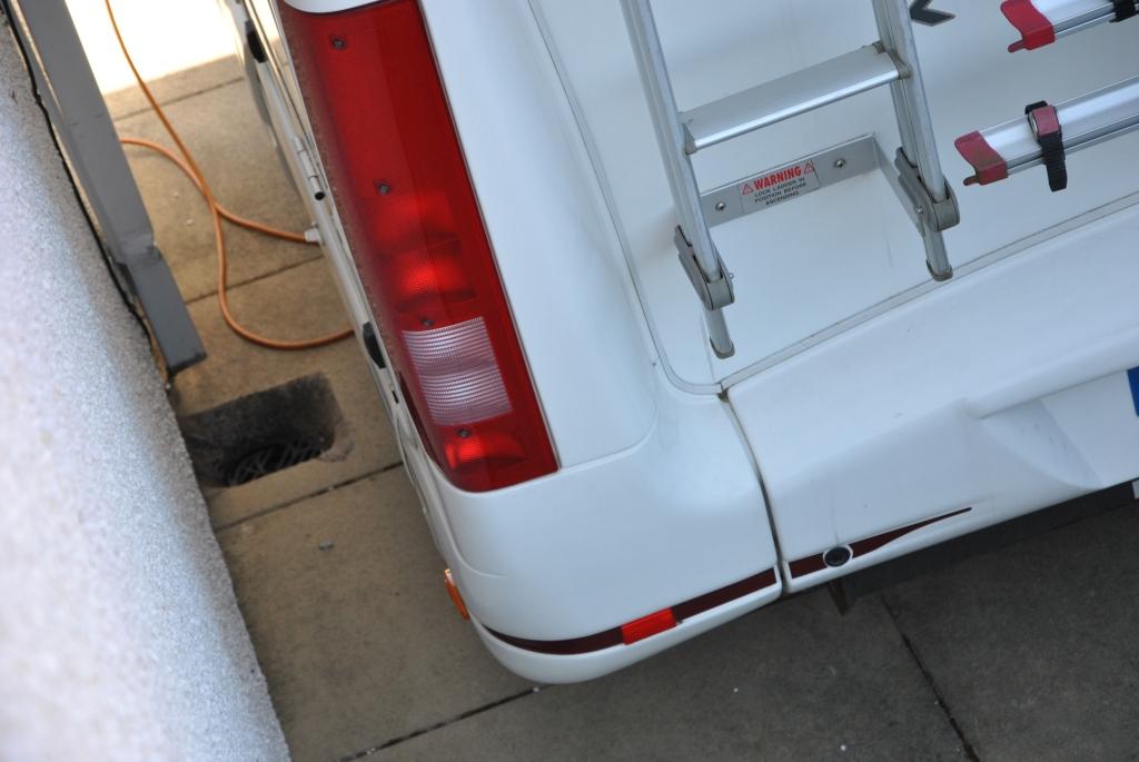

I have a Fiat 2.8 Swift Kon-Tiki 645 has anyone ever stripped of the rear quarter panel this one goes from roof down to bumper and has the rear light cluster attached. It has one screw fitted in centre under small rear light at top, my current camera cable definitely runs down inside this panel. Sorry if this is not clear but sure if someone has this Swift Kon-Tiki 645 they may well understand the above.

Hi chaps atached some pics to give you an idea of side rear panel I want to remove.
Bottom of side panel.jpgBreak Light.jpgFull side panel.jpgRear View.jpgTop and side panel.jpgTop and side panel joint.jpg
smaug has it in one
hi,looking at your pics i agree with "smaug",but if you have to drill all your cupboards,i would look to find a route underneath your wagon.you can follow the loom from the rear to the front,then into the engine compartment,just ty wrap the cable to the loom as you go,i will be getting mine done in the near future,good luck what ever way you go
There is usually a less difficult alternative...
Had a similar problem with fitting my reversing camera, but you should find that if you take both of your din plugs (one for each camera) and pull one of the leads back ~ 3-4" behind the other plug, you can then wrap masking tape around both in their new position (one behind the other) such that the two plugs are in 'line astern' and the whole gubbins is smooth and streamlined. That way both plugs and their associated wires can get pulled through an orifice the ~diameter of one plug, Bingo!
All you need to do now is remove the masking tape and your problem is solved.....(with a bit of luck)
