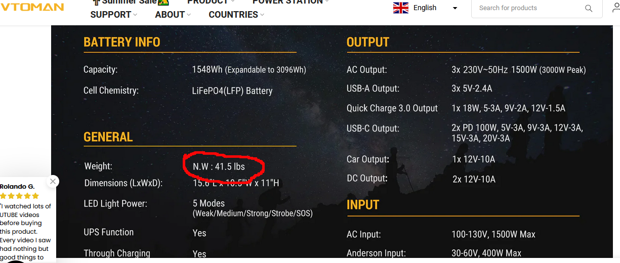

Wow the.votman is the answer ,and the price is unbelievable i would like find the weight?
According to the specs it's 41.5lbs, so around 19kg 🤔
Don't forgot that Gordon can help make them even cheaper (y)
