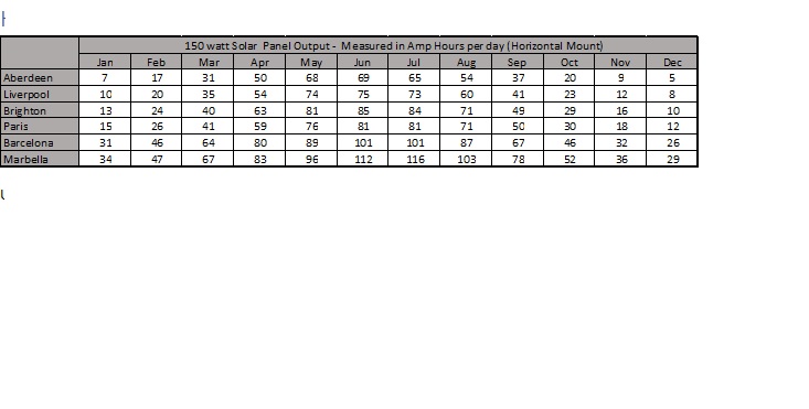

The table below shows a typical daily harvest from a 150w horizontal roof solar so you need to take a third of these figures.
As you can see you should be OK anywhere in July but the rest of the year is a different kettle of fish.
If January in Marbella it will take a couple of days to replace 50 ah and in Aberdeen about 10 days.

The suitability of your solar depends of what time of year you use the van and whereabouts you are.
