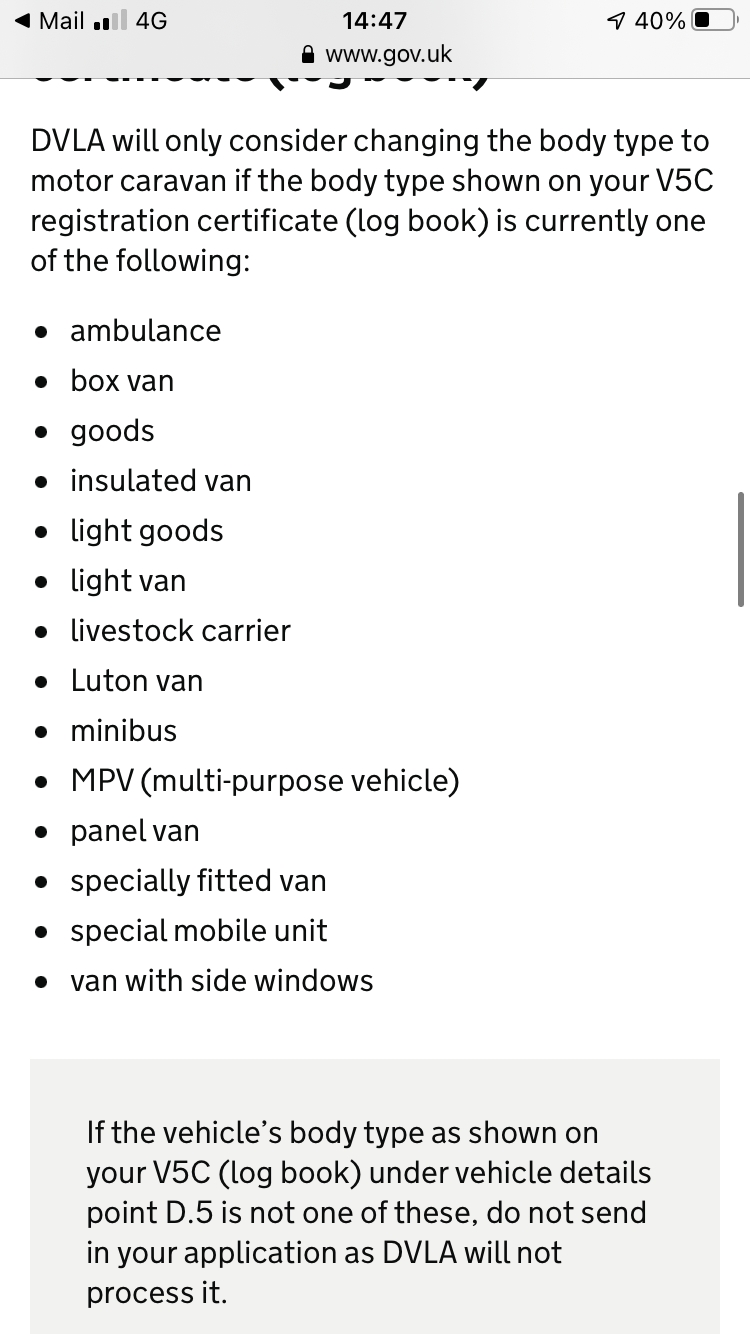

I will give it a try but it does say at the bottom if its not on the selected list it will be rejected instantly.
Link for tax is here: https://www.gov.uk/change-vehicle-tax-class/tax-due-to-run-out-or-changing-if-vehicle-is-exempt
Might be the wrong thing to look at?
Can you tell this is my first time 🤣
here is the list also of vehicles.
i was thinking try minibus across to motorhome. Not much info but i imagine like you say once the v5 is back il just send it again once conversion is done.

With regards to the £100 European recovery insurance, yes it's been tried. First three recovery companies never turned up. Thirteen hours latter one did, big enough to pick up anything.
As for the vehicle in the picture, still under conversion and insured with the same company. No reduction in price for being in our yard. Permission required to take in for a MOT when road worthy again.
Both single deck bus/coach.

I've only gone through the process of Change of Body Type more than 2.5 times
myself! And a few straightforward conversions. There have obviously been a few changes
since the last time, I've noted 'the list'. The Post Office still have to send your VC5 to the
DVLA Swansea for approval and processing.
Real shame your vehicle type is excluded, can only speculate why this is the case, large bus conversion were popular years ago, maybe they just thought it good thinking to get large
private vehicles off the road......a long shot guess.
If you're keeping it off the public road whilst converting then you can possibly
afford the time waiting for the documentation to go back and forth a couple of
times. There's always plan B to stay as you are.
Changing a Bus to a Minibus sounds like a very reasonable thing someone may do.
Reasons being licence restrictions (you have a D1 and not a full D) and you want extra luggage space that is freed up once you take out the seats to leave no more than 16 passenger seats in place.
Once you have a Minibus, you have a vehicle that is on the approved list for conversions for a later reclassification. (I reclassified my van twice in one year ;) )
Ref the tax, when I changed tax class, I had to get the new tax to start with at the post office rather than on-line. Just a one-off thing and after that could carry on doing on line to renew, SORN, etc.
I don't recall having to take insurance certs or MOT cert (and apparently MOT paper certs are no longer issued anyway) - these are all accessible via the various databases anyway, but I guess wouldn't hurt to have with you anyway

A few points . Vosa(Now DVSA) HGV test sites all outsourced bar about 3 or 4 . Private sites are known as ATF now . They cannot test class 4 . They may physically use the same equipment , but it will be a private mot tester not a Govt (DVSA) vehicle standards assessor , operating when it is not actually being used as an ATF . To get a class 4 test the vehicle will need to be converted internally to comply with the GOV std for motor caravan (there is no such category as motorhome) . https://www.gov.uk/government/publi...caravan/converting-a-vehicle-into-a-motorhome This is enough to comply with self dec for class4 mot . and usage as a motor-caravan. To try and get a change to body type of motor-caravan in the V5 you also need to comply with the external requirements listed by GOV site and fill in application form https://assets.publishing.service.g.../v1006-motor-caravan-conversion-checklist.pdf This will not actually get you motor caravan in V5 unless they decide that its appearance is sufficient , (very rare) . This does not stop you using as a motor-caravan or any rules that apply to motor-caravans . If below 3500kg tax will be plg , over3500 it will be PHGV . Driving licence will be decided by weigh (MAM)
Your current V5 has to be as previous poster says have a suitable vehicle body type to be considered. This may necessitate going from start vehicle to intermediate type then application for motor-caravan. A minibus is a vehicle with 8 to 16 seats + driver . There is no weight limit other than when considering licence to drive . (This was alluded to by @wildebus ) :) HTSH .
Just book it in for mot and thats fine . No permission to drive to or from test center just a paper trail.
Vehicle Need to be insured but you can cancel upto 12 days it if it fails.
Ref the MOT, this is how I understand it, as long as you have a timed booking.
What is not defined as far as I know is how far away the MOT test station can be? You can't book a test 100 miles away probably and have a day out at the same time :D
I used to do Doncaster to Westbury in Wiltshire until I found somewhere up here to do it.
Are they an ATF (Authorised Test Centre) carrying out both Class 4 and Class 7 testing,
or just Class 4 with large vehicle testing capabilities, eg. a pit, perhaps large commercial
brake tester etc. facilities?
