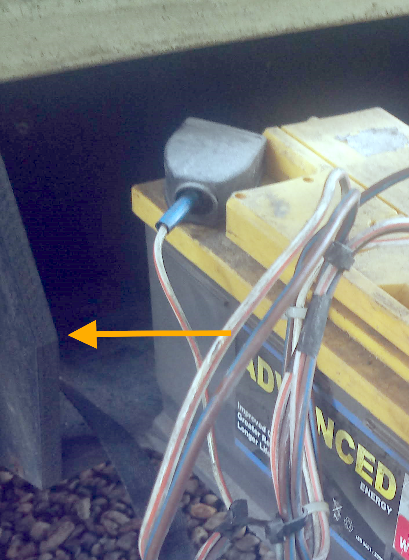

There are some underchassis compartments in my Motorhome. They are constructed with some kind of "fibreboard".
Not a great picture but the arrow points to one of the verticals in the battery bay
I am looking to do two things - make a new box somewhere to carry a long pop-up gazebo thing (nice area towards the rear wheels perfect for that :) ) and also either modify or replace the existing battery box to allow me to fit more batteries (room for 2.5 right now, so 3 would make more sense :D ).
So that is the aim, but what is this construction board they used and where can I get it? It looks good stuff as it is holding up very well in these exposed areas so the same again would suit nicely.

Absolutely, Phil.
The battery box is made of whatever the board is, but crucially there is a metal strap underneath and attached to the chassis as well as the rear part supported by a chassis member. The plan is to basically keep the same general dimensions except make it around 10-20 cm or so wider (and expect the weight to be probably lighter, or if more, not much more)
