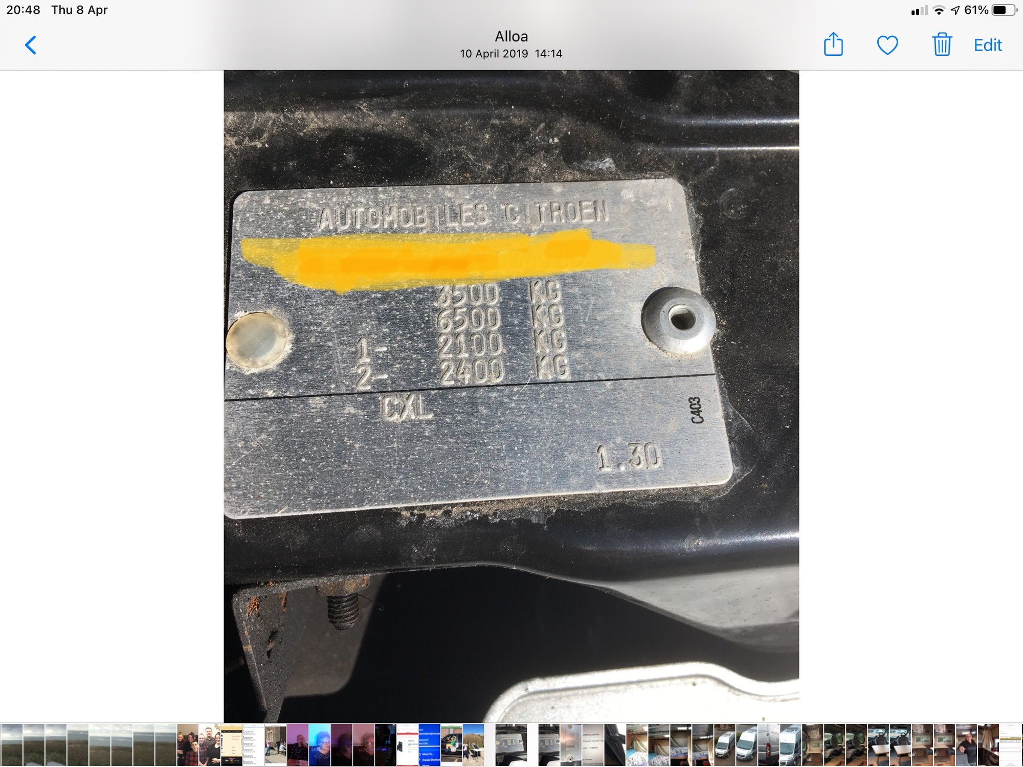

I have a 2011 maxi and it seems that the two axle weights add up to 4500kg, what baffles me is that the first number is only 3500kg!!
It is usual for the individual axle limits to total more than the overall max.
In manycases the MGW is reduced to 3500kg for marketing purposes, and can be upgraded to over 3500 without any mechanical change.
That’s because your maximum weight is 3500kgs. You have to keep the overall weight to that and also make sure you don’t overload each axle.
Would have thought it unusual for the combined axle weights to be 1000KG over the GVW.
Not really, there must be thousands of Maxi chassis vans with 3500kg, the reason being at first with X250 all XLWB vans where built as a preference on Maxi chassis even if you only wanted 3500kg, our van is one. However I believe now with the XLWB X290 it is more common for them to be built with light weight chassis, this has become a problem for those people who have specified a light chassis on a long van, the rear axle often becomes overloaded before getting near max weight.
