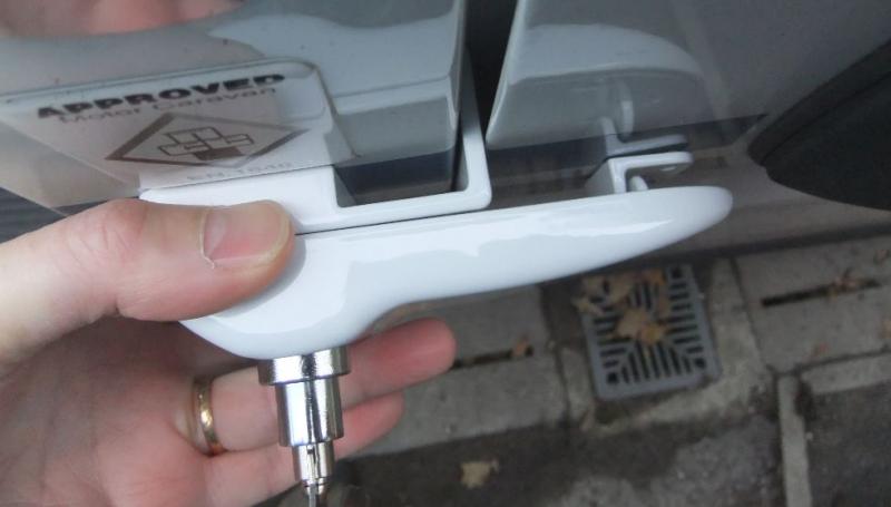

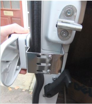

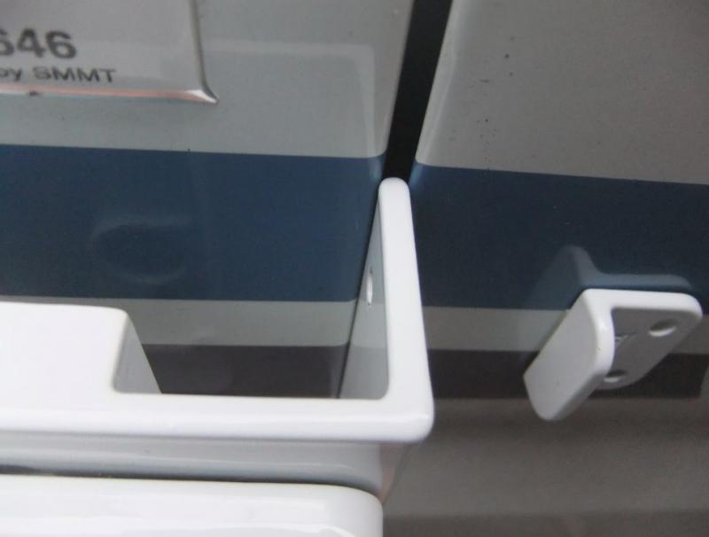

Next I had a look at how the 'Safe Door Frame with Minivan Spacer Kit' would fit on the sliding door. This does not look like a good design. The right angle bracket does not fit into the gap when the door is closed but if the bracket is inserted before the door is closed the door can be closed. Which means that the door must be 'bouncing off' the bracket as it closes.Sliding door 1.jpgSliding door 2.jpg

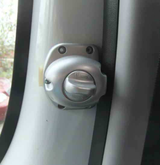

Next the 'Guardian' cab locks. I am now wondering what the point of these are as if the window is smashed it can be easily opened! To fit a slot needs to be cut into the trim. On the agentfiamma.co.uk website it says 'Fitting: Screws supplied. Replaces existing cab door catches' - I cannot see how the device replaces the existing cab door catches.Cab door 1.JPG

sorry i can't help you with the problems you have found, but i have fitted similar security as the guardian cab lock, except my i made from a rack bolt and thumb turn (total cost £10.00), can be undone from outside if window smashed but my purpose for fitting is so we can secure the van doors from the inside only when we are out w camping. (only operable from the inside).
