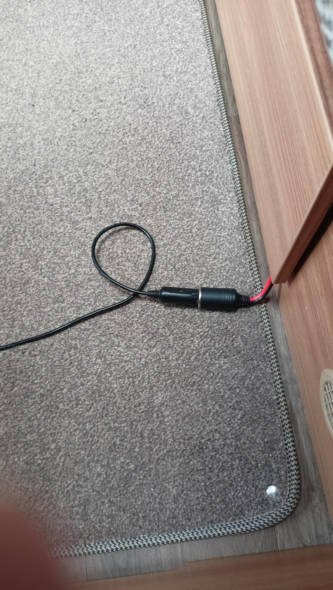

I am hoping @MERL will see his has he knows my van but it would be useful to have another 12v trailing heavy duty socket in the front dinette. When we (well Merl) upgraded my batteries and solar system we fitted two of these which just flip out from the bottom of the rear lounge seats when needed. They are great. Very useful but there are none in the front. I could do with one coming out of the front dinette.

This is one of the ones in the rear.

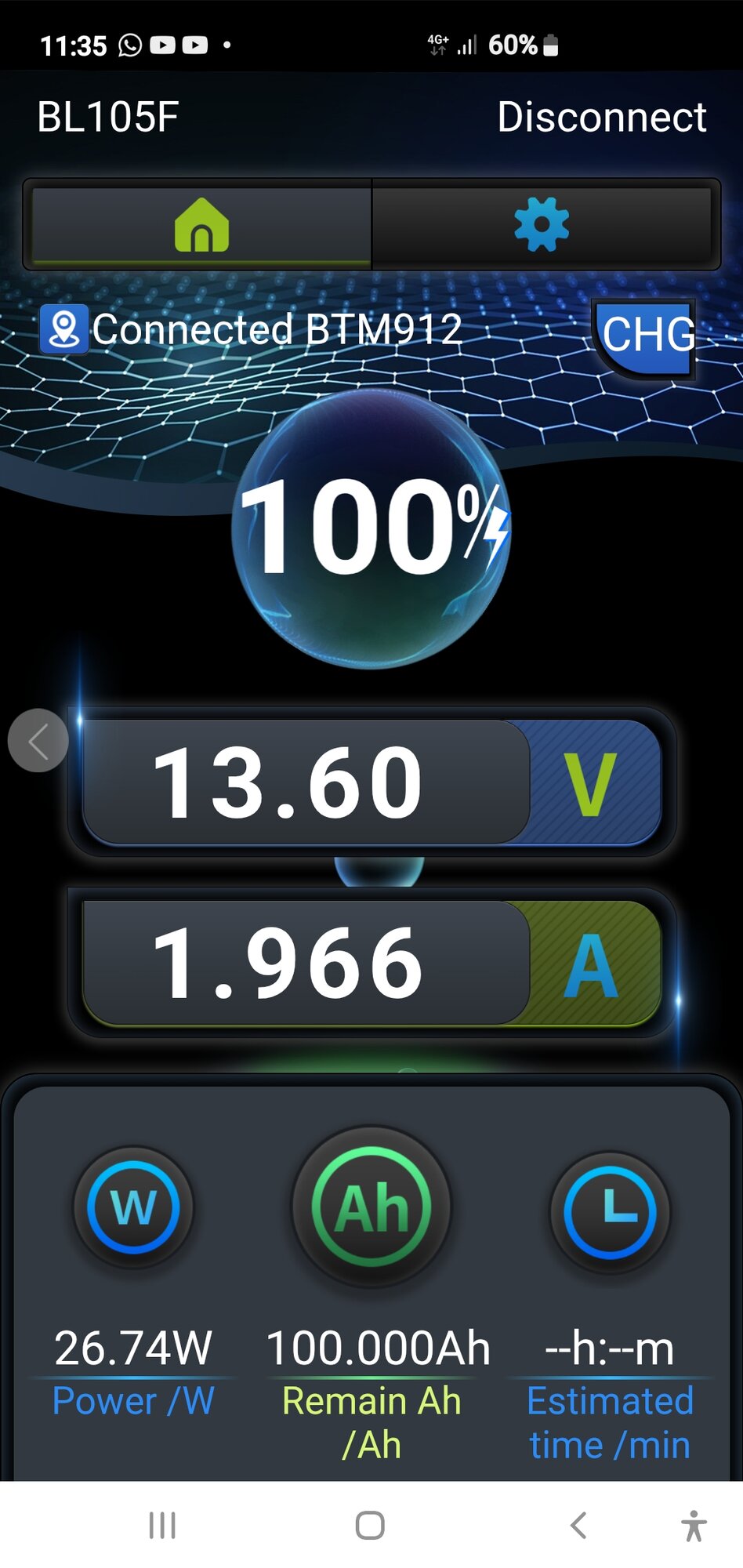

Im not doing that right now as everything works just fine. Merls super duper solar install has worked fantastically on this trip. Weather has been a bit indifferent these last few days but its still charging extremely well. Never dropped below 12.55v in 8 days without moving which I think is about 80% full.

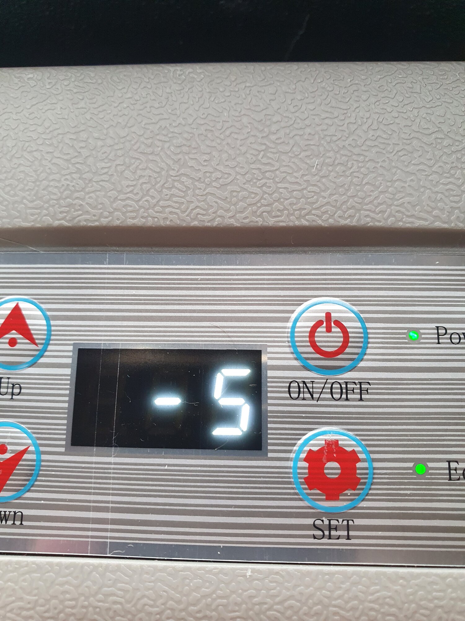

Me too, it's cloudy here as usual, I put the new alpicool thin on about 20 mins ago and panel is in front of it, it's just reached its target of -5, waiting for it to switch off.
Me too, it's cloudy here as usual, I put the new alpicool thin on about 20 mins ago and panel is in front of it, it's just reached its target of -5, waiting for it to switch off.View attachment 206876View attachment 206878
What does -5 mean?
I just watch the Victron app. There is a good game to play where you guess the watts going in depending on the weather when its in bulk. One of us is usually within five to ten watts. :D
