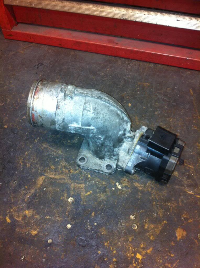

All egr valves are different here is one I believe is off a 2008 x250 base van not mine I read about it on an autosleeper forum dealer price £600 I think the owner found one for £300. Apparently water runs off the scuttle into it and seizes it up.

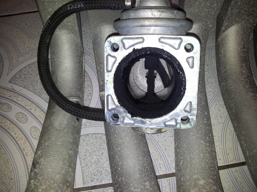

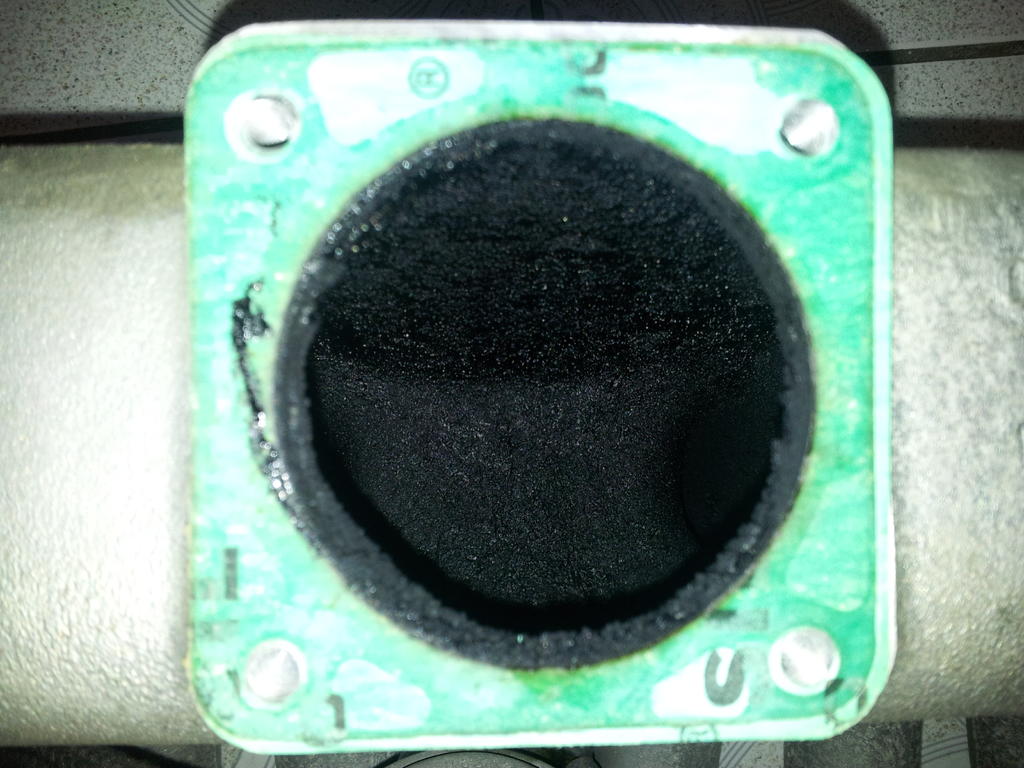

Yes i think they open and close quite a bit under different driving conditions i know on my vw lt when i hook it up to my computer it shows its duty cycle. I stripped mine down and cleaned it all and the inlet manifold last month when doing my timing belts also blocked it off at the exhaust manifold. Has been ok no warning lights as mine is vacuum operated. Here is a picture of my valve and inlet at 30k miles not too bad but still a lot of sticky black mess in the inlet manifold.20140422_202301.jpg20140422_202306.jpg

Yes i think they open and close quite a bit under different driving conditions i know on my vw lt when i hook it up to my computer it shows its duty cycle. I stripped mine down and cleaned it all and the inlet manifold last month when doing my timing belts also blocked it off at the exhaust manifold. Has been ok no warning lights as mine is vacuum operated. Here is a picture of my valve and inlet at 30k miles not too bad but still a lot of sticky black mess in the inlet manifold.View attachment 23391View attachment 23392

Don't forget to plug the vacuum pipe if you pull it off the actuator. Don't leave it dangling open.
Left all the vac pipes connected as i think it would bring up an error if i plugged it as it all feeds the vnt turbo and ecu via the n75 valve. The egr will still be working (opening and closing) just no nasty exhaust gas going into it anymore.
