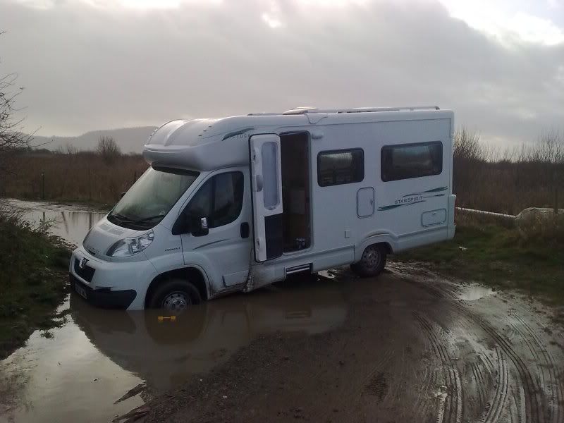

Jesus i thought we had had problems,interesting thread and a great photo this one as we had this happen to us late one night near usk on the brecon beacons.We were aided by some army folk on there way to a day of quad biking nearby,they pushed us out but boy did we (in particular the wife) have a sleepless night just a shame we could nt have enjoyed the view.I wish we had of had a camera as i was trying to dig my wheel out with a fiamma block the next morning we had an audience of about 40 sheep watching us in the road,for some reason they found us to be quite a draw:D,that was the only smile for a few hours that morning too!!
I now have a shovel in my van,but looking at this thread made me realise i could have jacked the wheel up and made life easier for myself,well i suppose you live and learn at least im not the only one lol
You deserve a prize for that photo,i imagine that photo was taken for a reason probably to rub your nose in it.
