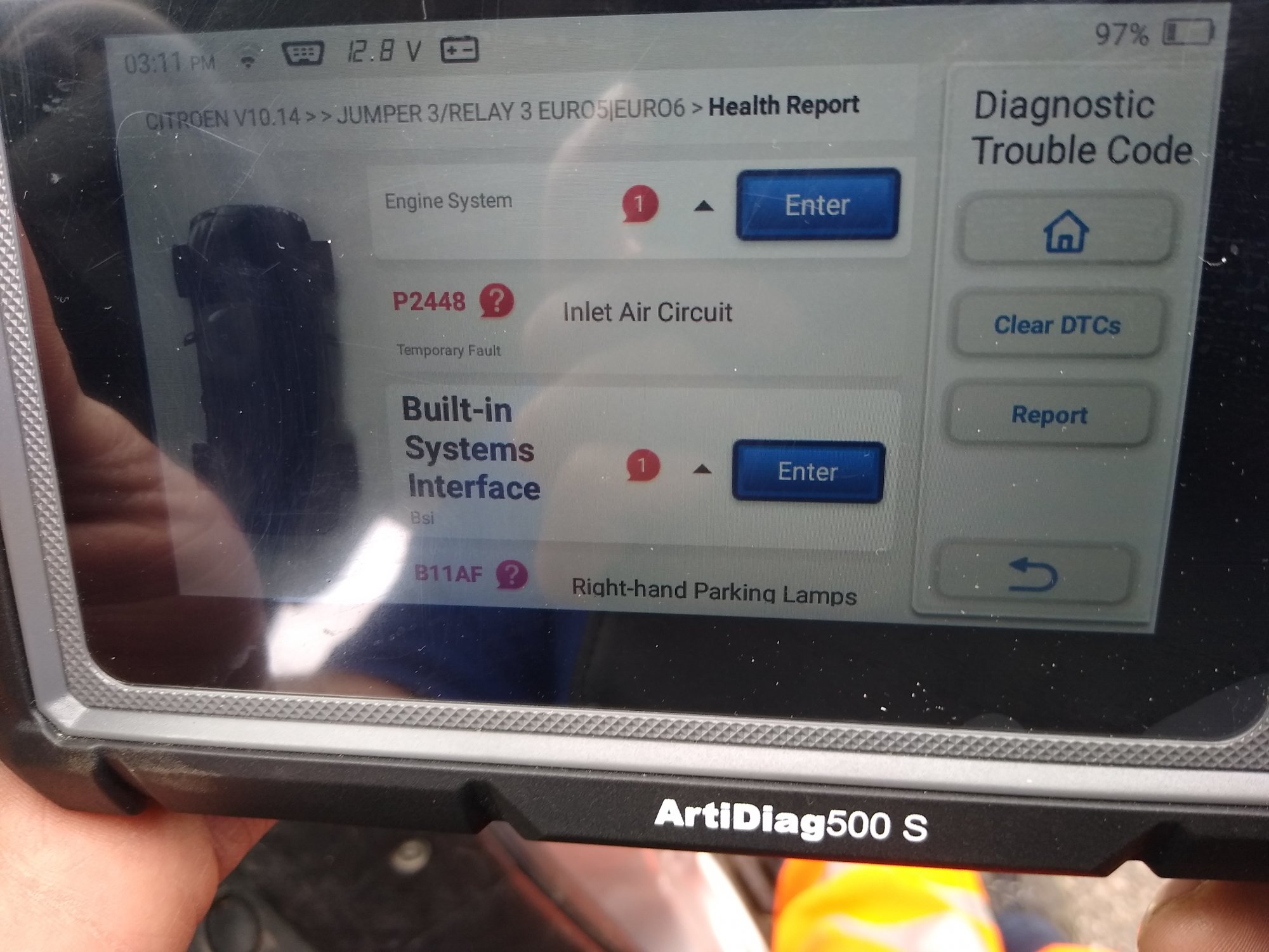

18 plate Relay. Nox sensor replaced in Jan, now (aaaarghhhh) another engine fault showing this time Air intake P2448 fault code. Van in limp mode plus unusual whistling sound when engine under load above 1800 rpm ish.
Friendly breakdown man inspected terminals on the air intake sensor and did visual inspection of all relevant pipes ( turbo etc) as far as possible at roadside. Nothing obviously wrong so he deleted the fault code and with the vehicle idling all looked well.
I resumed my journey and within a mile as soon as I accelerated the fault returned. I've since limped from Inverness to home in East Lothian which was ok apart from 40 mph on long uphills. Could achieve 60+ on the flat with light throttle.
Questions.
1. Anyone encountered this fault and any wisdom to share.
2. My son's due to use the van for a 250 mile round trip at the weekend. If it's not fixed, are there any risks to the van in doing the trip in limp mode?
