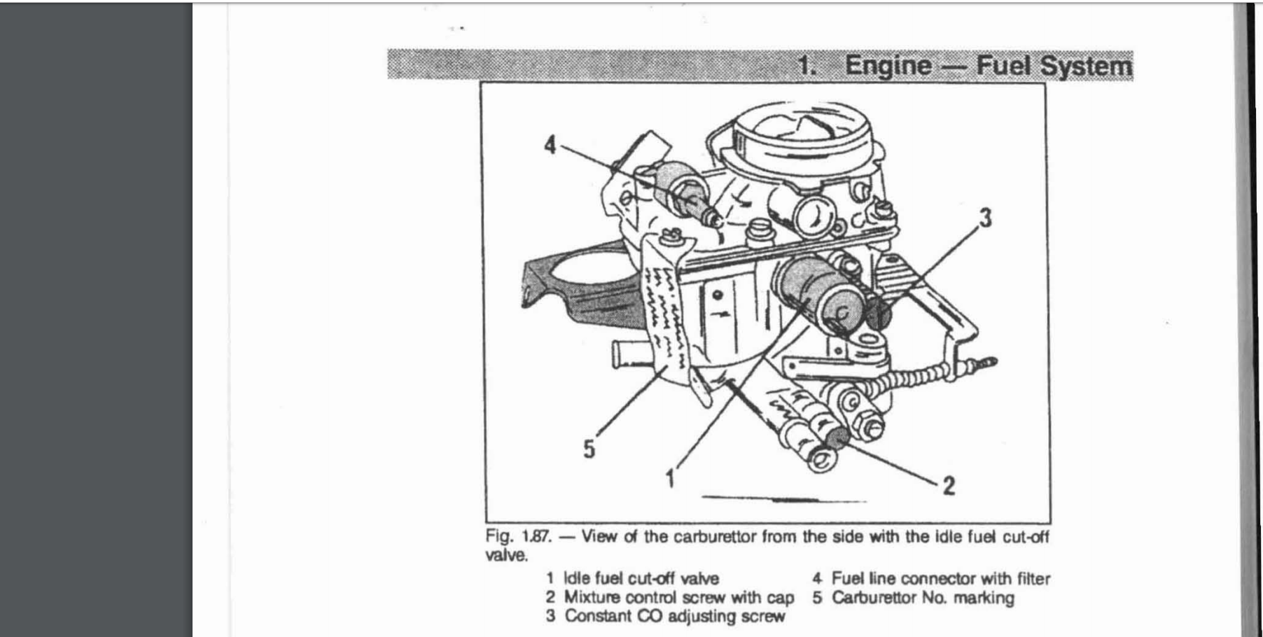

Not much hep, but on most carburettors the idle mixture screw is just that. It will have next to no affect on the rest of the range. Without knowing the type of carb I can’t offer any help.
It was screw 3 that the mechanic adjusted and that I also adjusted a quarter turn, I think, maybe I should have adjusted screw 2 ? @SquirrellCook
Full manual, I got the picture above from page 76 of the Russek Petrol Engine Manual PDF
For Full Manual it is here https://ra-w.uk/TALBOT
TIA
So life is easier as it looks like a conventional carburettor. Just have a good look around to see if any little rubber pipe fittings have been split with rough handling. If all looks good pop the top of the carb, looks like six screws. What you don’t want to see is dirt or debris in the bottom. If it’s clean it suggests that something simple has happened and probably hard to find. This is working on the theory that all was well before it was subjected to finger trouble. I expect the idle mixture is messed up now and is best corrected with a gas analyser Rough running at idle can be put up with until you can get it to a garage with an old mechanic.

Screws 2 & 3 are for idle mixture control,one air the other fuel,dont fiddle if you cannot tune engines but get a old timer who knows the engines.
